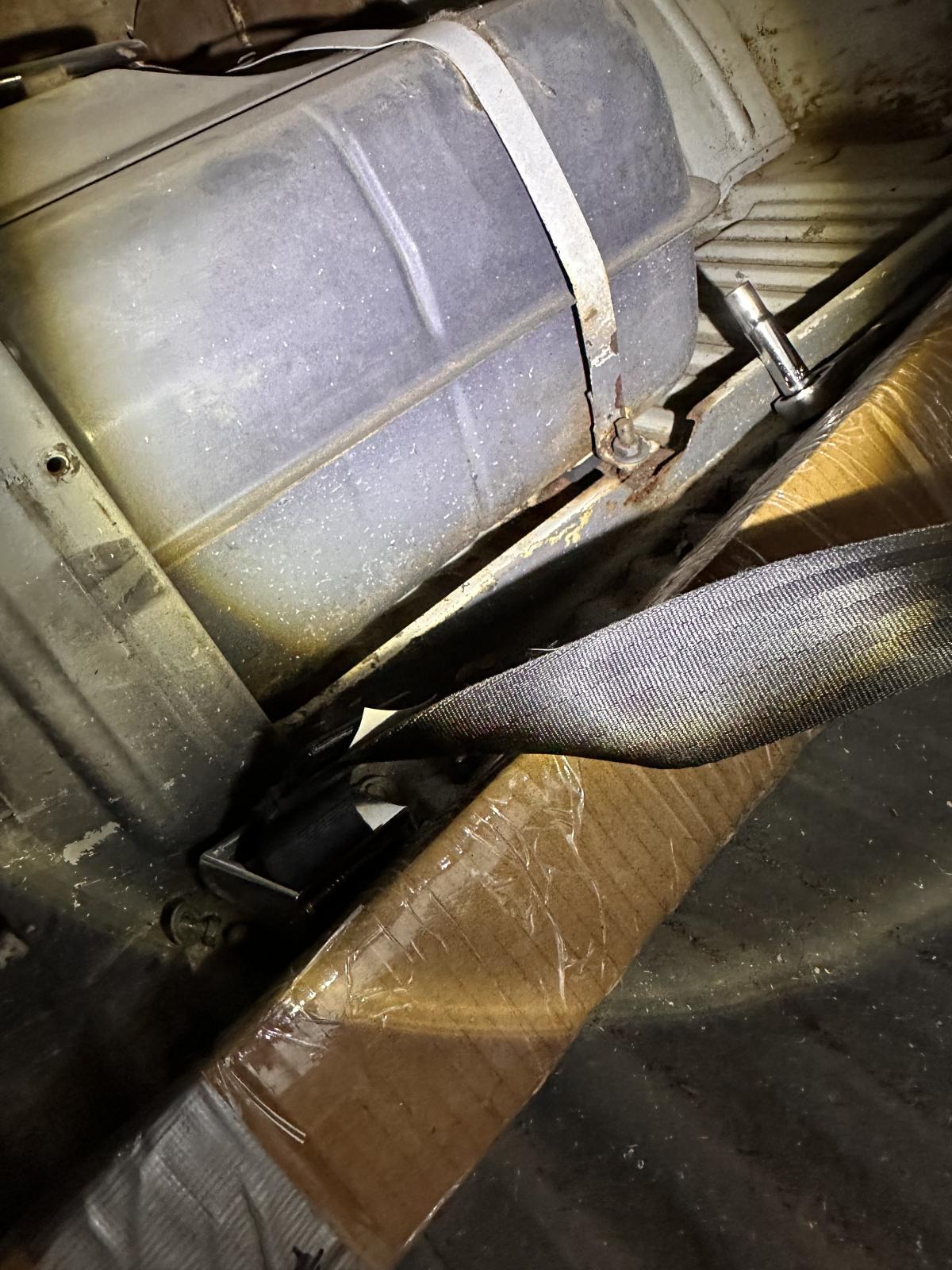

I recently started noticing gas smells while driving. The smell has gradually been increasing. It gets pretty bad when I fill the tank and goes away when I don't have a lot of gas. Isolating the smell of the gas has always been difficult. For some reason it smelled more strongly in the drivers seat than elsewhere in the van. It also mostly only smells if I'm driving. I live full time in the van, so can verify that it doesn't leak when sitting.
Checked the main fuel lines and the air breather hose behind the spare tire wheel. Everything clean and tidy. Popped off the plate to check out the filler hose and all good there. I noticed under the bus a small wet spot coming from a bolt that looked like it could be coming from the gas tank area.
So my next thought was that I need to examine behind the fire wall. My hope at this point was a breather hose had popped off, but I'd replaced them 4 years ago with the Gates Barricade line and stainless steel hose clamps. Same with the filler hose rubber. New gasket for the sender, etc. Everything new and redone to avoid exactly this.
I sacrificed some pristine looking engine tin in the name of solving my problem. I'm in a small town in the Argentinian Andes, so dropping the engine a couple inches wasn't an option. Unfortunately, I observed no obvious easy fixes like a cracked hose. There was a nice undisturbed layer of dust around all the usual suspects: sender unit, filler tube, breather hoses, breather tubes.
What I did find was this:
Sorry it's not the greatest picture. I'm not really sure what to make of it. My best guess, given the line across the wall is that perhaps the seam is weak and when pressure builds up in the tank while driving it is spraying the side wall? That sounds a little far fetched, but literally none of the other points of leakage are leaking and the seam is all that I can think off.
This was pretty much a rust free gas tank when installed 4 years ago.
Any thoughts?

Never heard of it happening on one of these rigs before, but maybe you have rubbed a hole in the tank? I have certainly seen this on tanks in other rigs. Just a rust hole would be another possibility.

I took a lot of videos with the flash on inspecting all around in there. The only thing I found was this area, which I do find suspicious. Like why is the moisture line exactly lined up with the seam. There's a small amount of moisture on that far corner and the near corner.
I guess I'm curious if anyone has ever heard of a seam going bad? I guess the seam is welded though.
What would make it worse when I drive? If I have the entire breather system functioning properly is it under pressure?

The metal near a seam can fatigue and crack with time.

It is possible your tank has pinholes in it, or that the filler hose is leaking slightly where it joins the tank.
The mark may just be where fuel is running along the bottom of that panel : it looks like there is a lot dust which may be allowing the gas to soak into the dust from the leak, soak all along the tank and then at a certain height it evaporates away.
Do not forget the tank breather join just in front of the spare wheel well on the drivers side, this could be leaking and the fuel is running forward along the outside of the breather pipe, and into the tank area.
It does not take long for fuel hose to crack in that position, the heat from the engine plus the fuel inside the breather when you fill up the tank soon weakens the rubber fuel hose in that breather joint position.
On the passenger side that breather joint is further round the breather system, after the loop in the air vent, so it does not leak fuel if it breaks.
