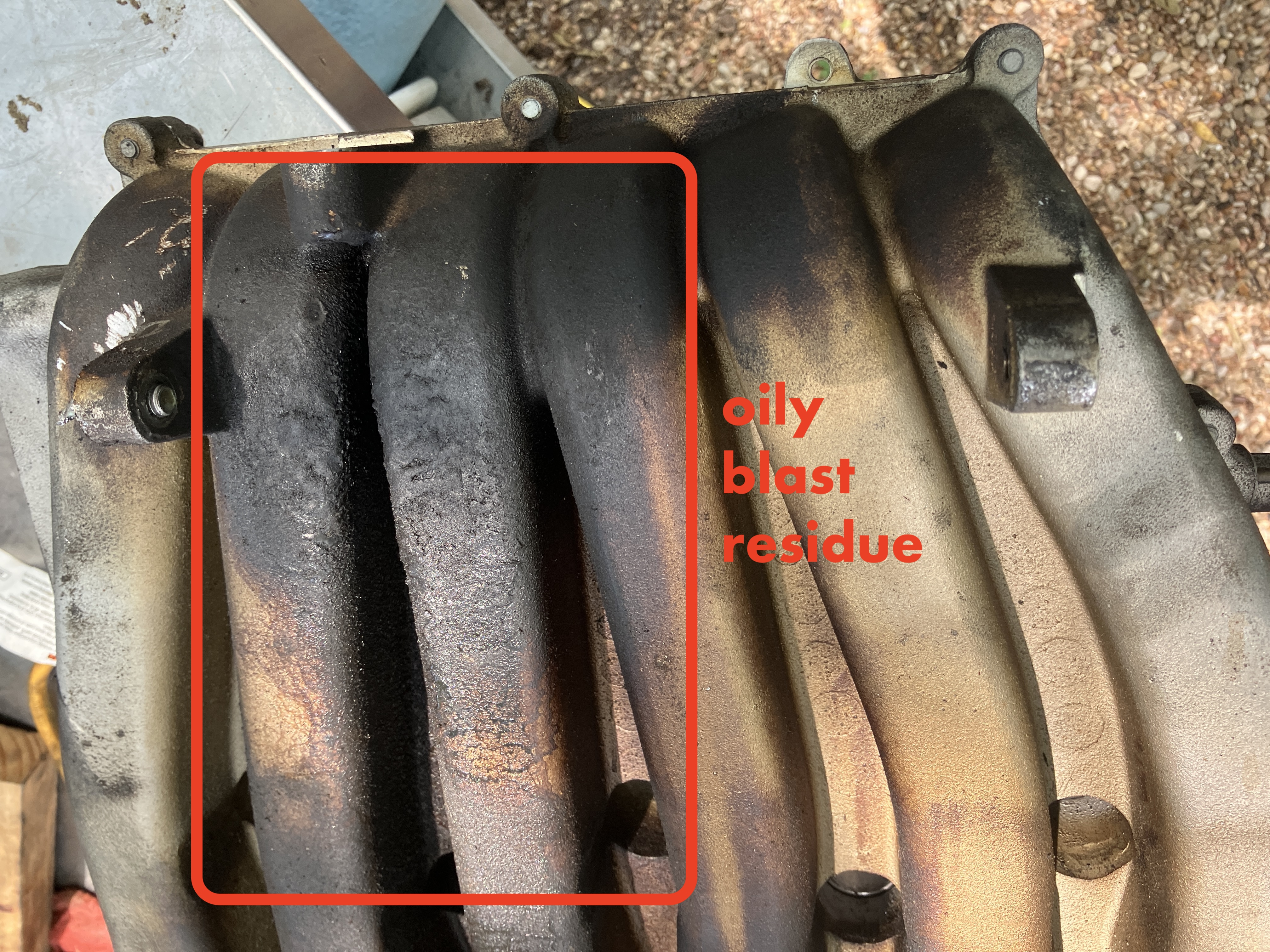

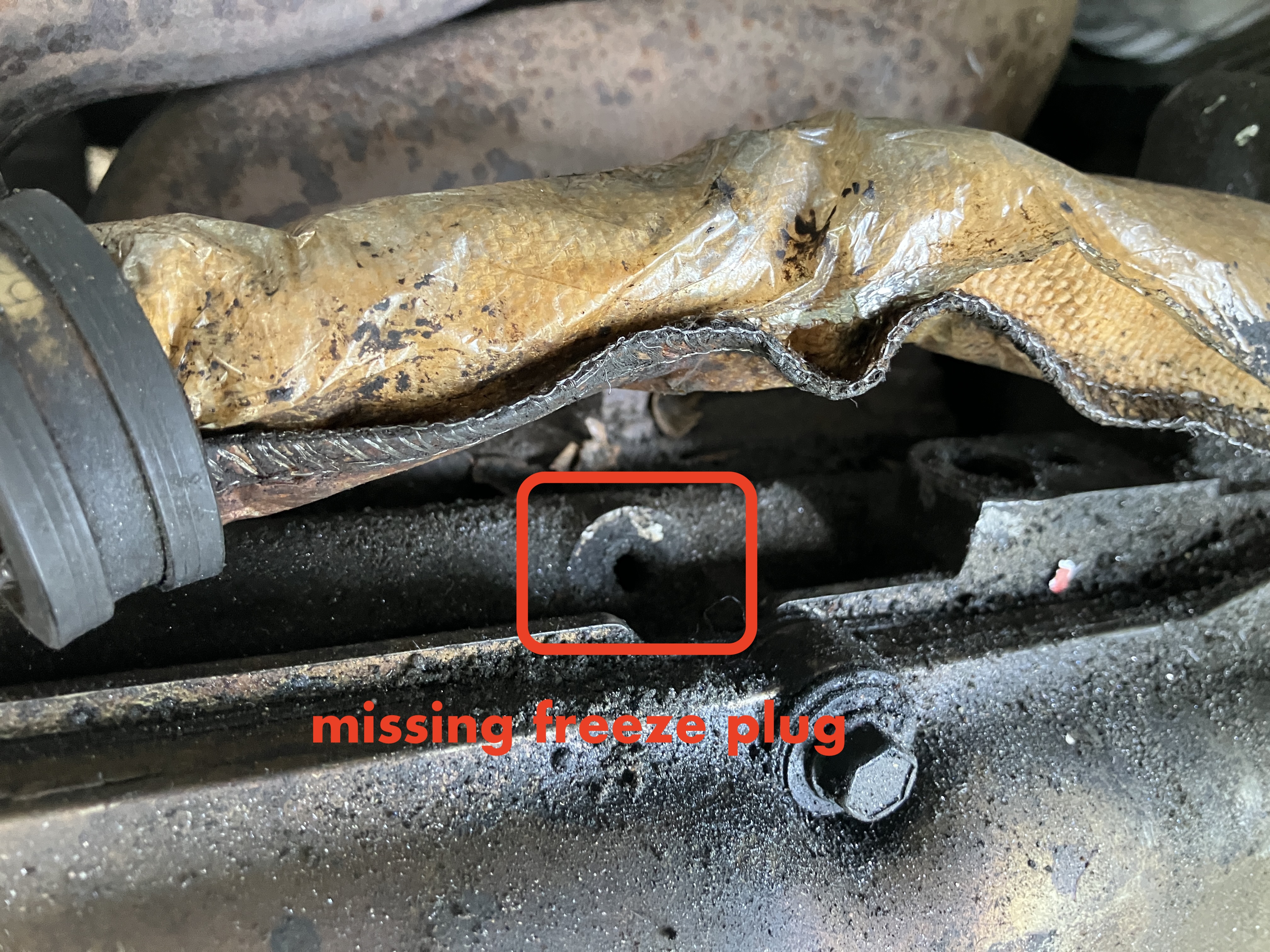

Update: I finally got the intake manifold off today. Bingo! Missing freeze plug.
The first evidence I had was when I lifted off the intake manifold and looked under it. It had a black/brown oily blast residue from something underneath it, blasting hot gases up into the underside of the manifold:

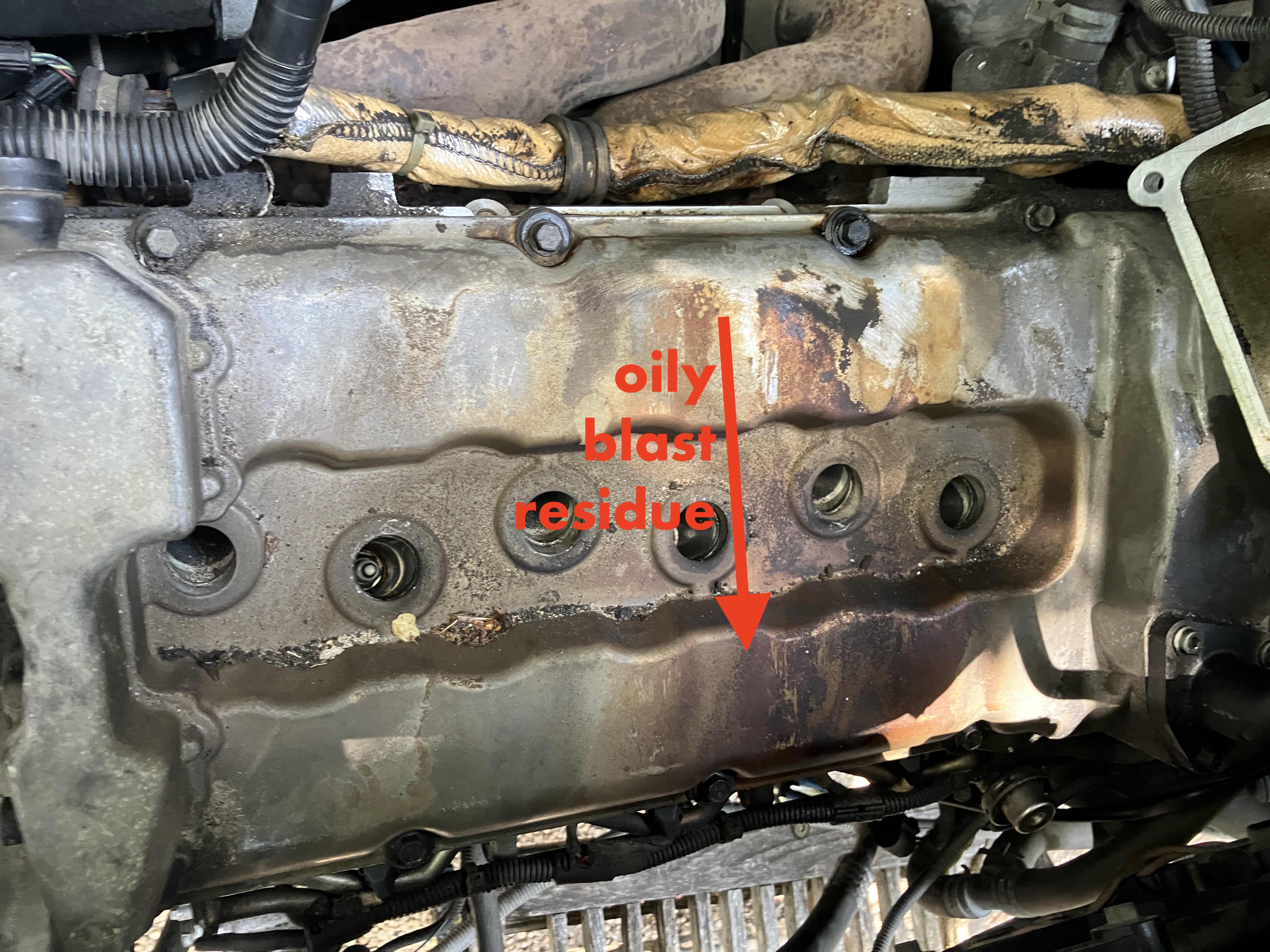

The top of the valve cover also had oil blast and residue running down:

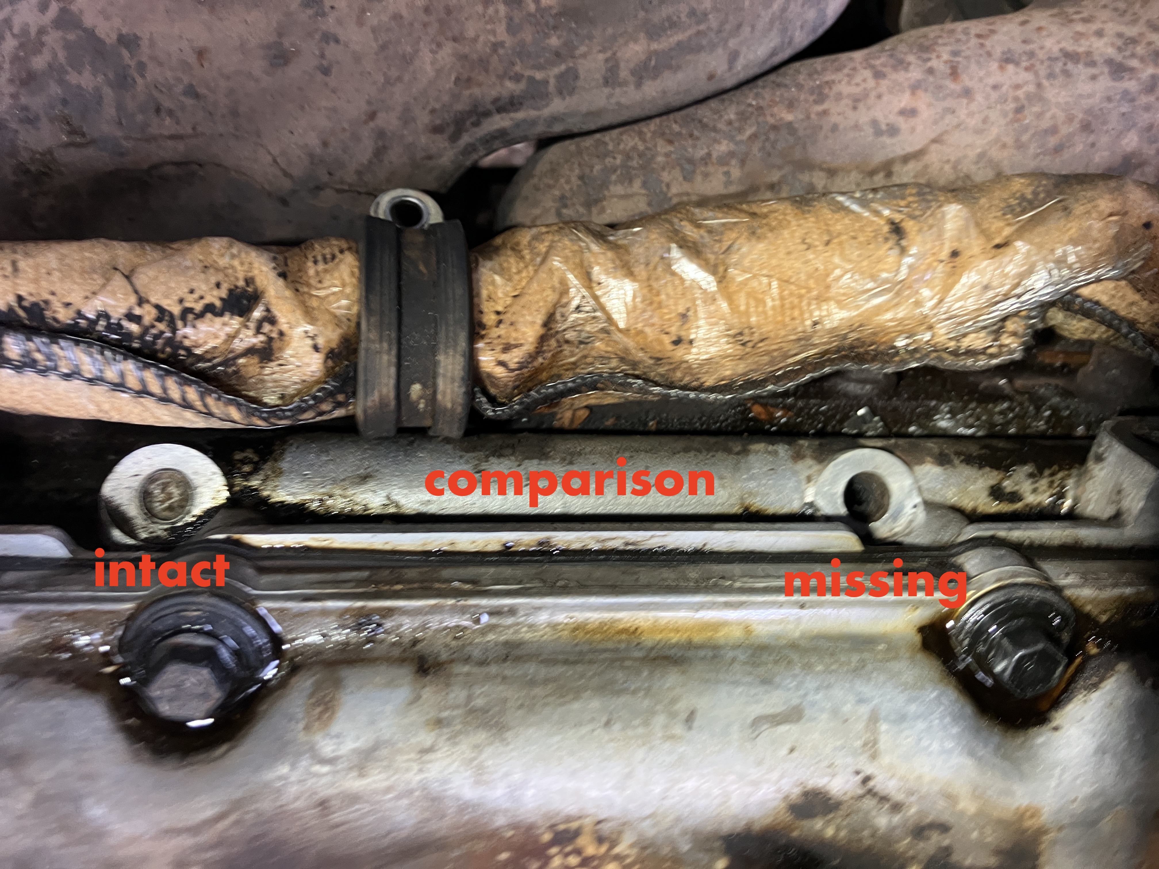

Here's the culprit:
Here's a cleaned up comparison:

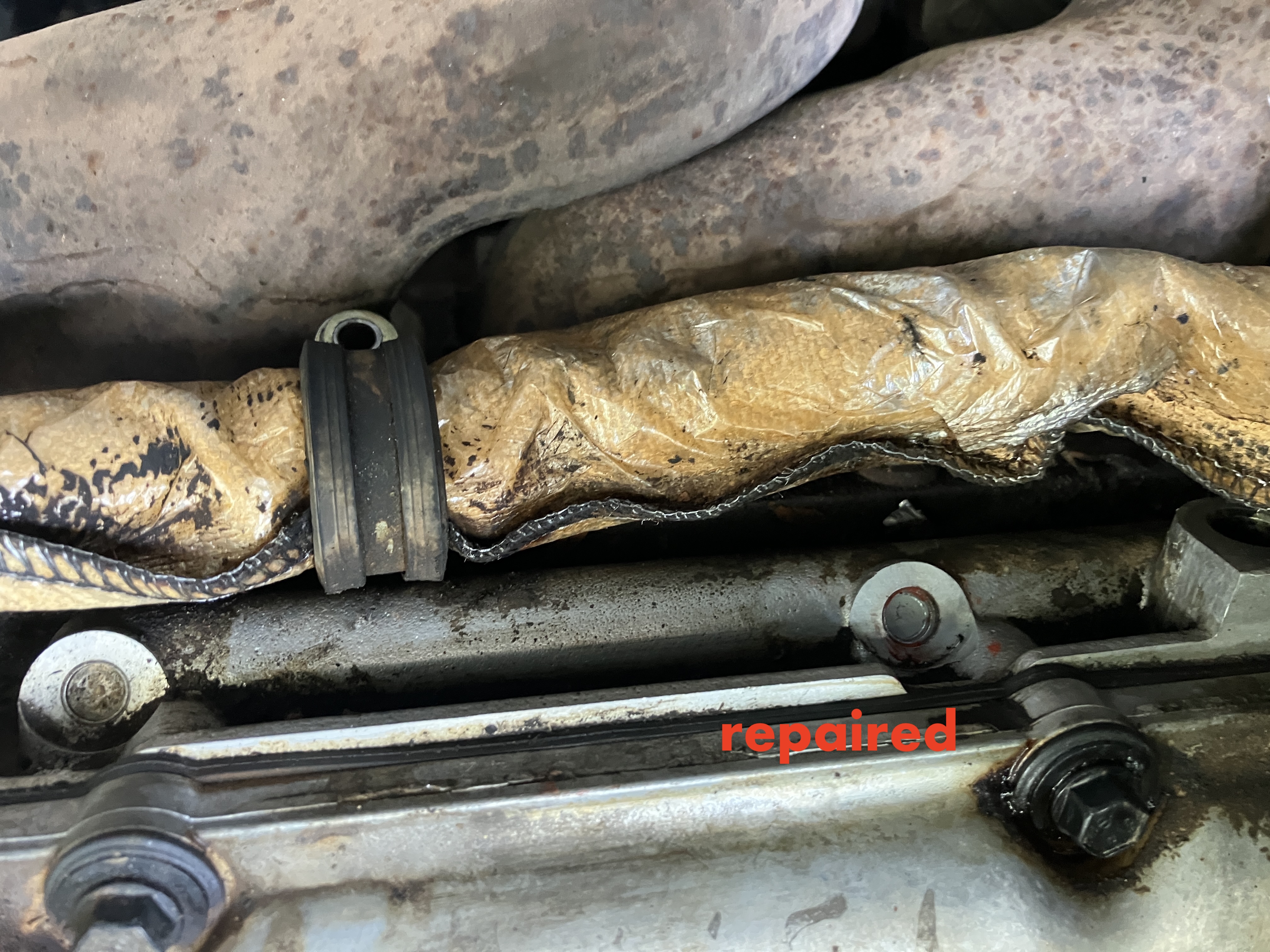

Here's the repaired freeze plug:
What a relief to have found this! I got the new 10mm VW freeze plugs at urotuning.com.
