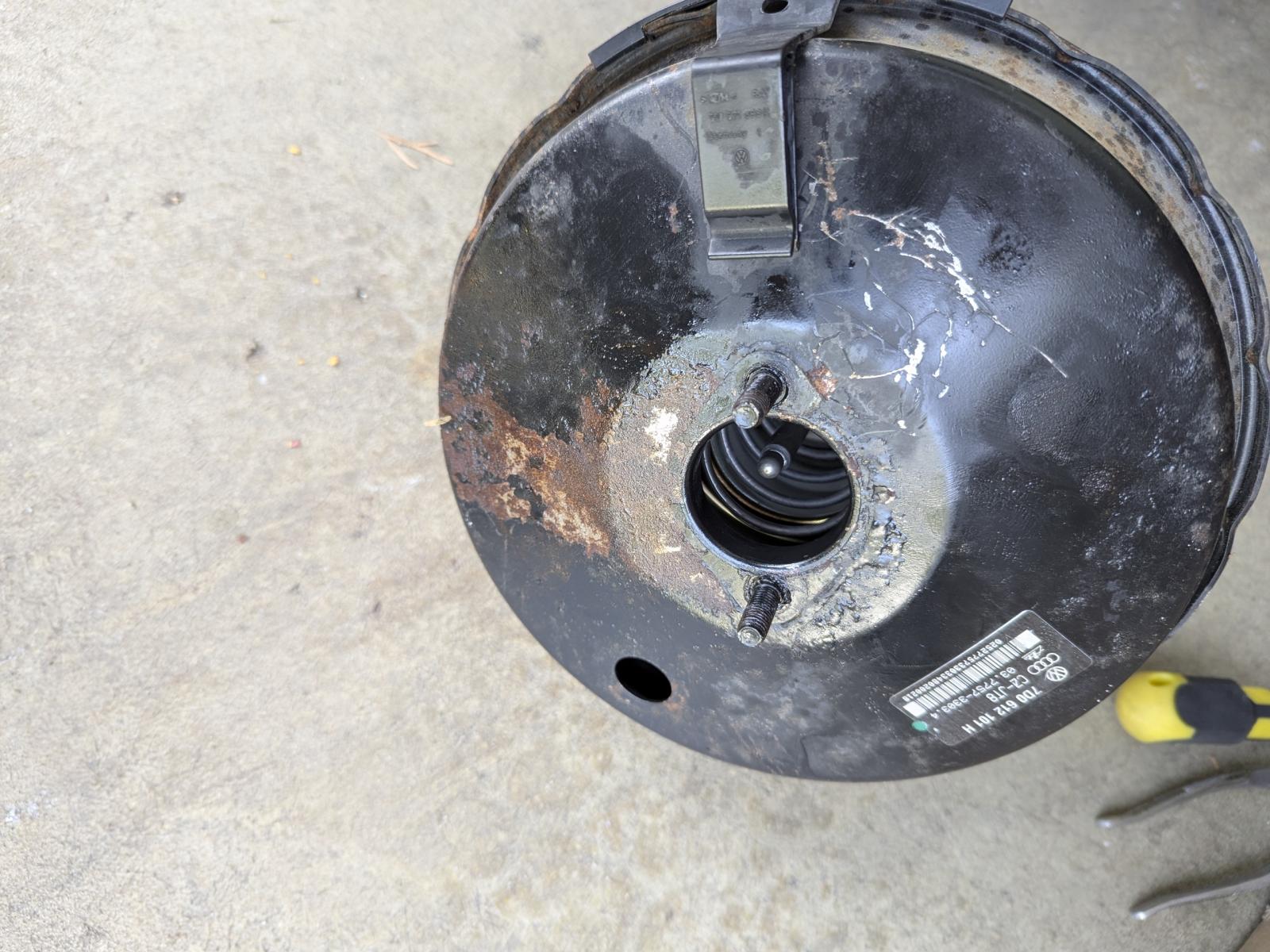

Pulled the booster. Was hoping to keep the brake & ABS hard lines intact since another member here reported they were able to push on the lines and squeeze the booster out. I didn't see a way to do that without severely bending the lines so I disconnected them.
Booster is out, and I've observed that the foam on the inside is very crumbly and *I think* might be damp as well. Examined the inside of the booster and the bottom metal on the inside appears slightly wet/shiny. Lastly, there is some rust and bubbled paint below the reservoir on the outside of the booster. So it's likely that the master cylinder has a small leak and should be replaced.
I've seen a raybestos cylinder on rock auto and amazon that is ~$75-80 shipped. FCP Euro has an OEM version made by ATE that is $244. They both look the same as the one I pulled out, although the ATE has the same numbers marked on it.
Anyone have experience with raybestos master cylinders vs OEM? Price difference is over $150 so I'd like to hear from others that have experience with this.
Hard brake lines detached and booster + master are out:
Foam is crumbly and possibly damp (from brake fluid?) on original booster
Evidence of possible brake fluid leaking down front outside of booster as well.
Booster and reservoir removed. Was gonna reuse but will now replace cylinder:
