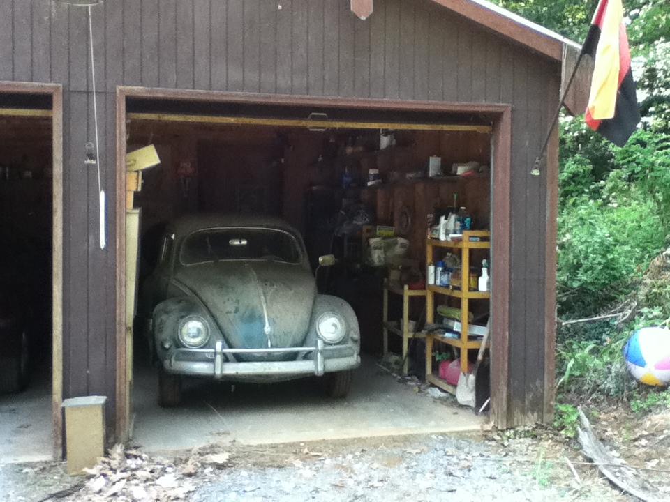

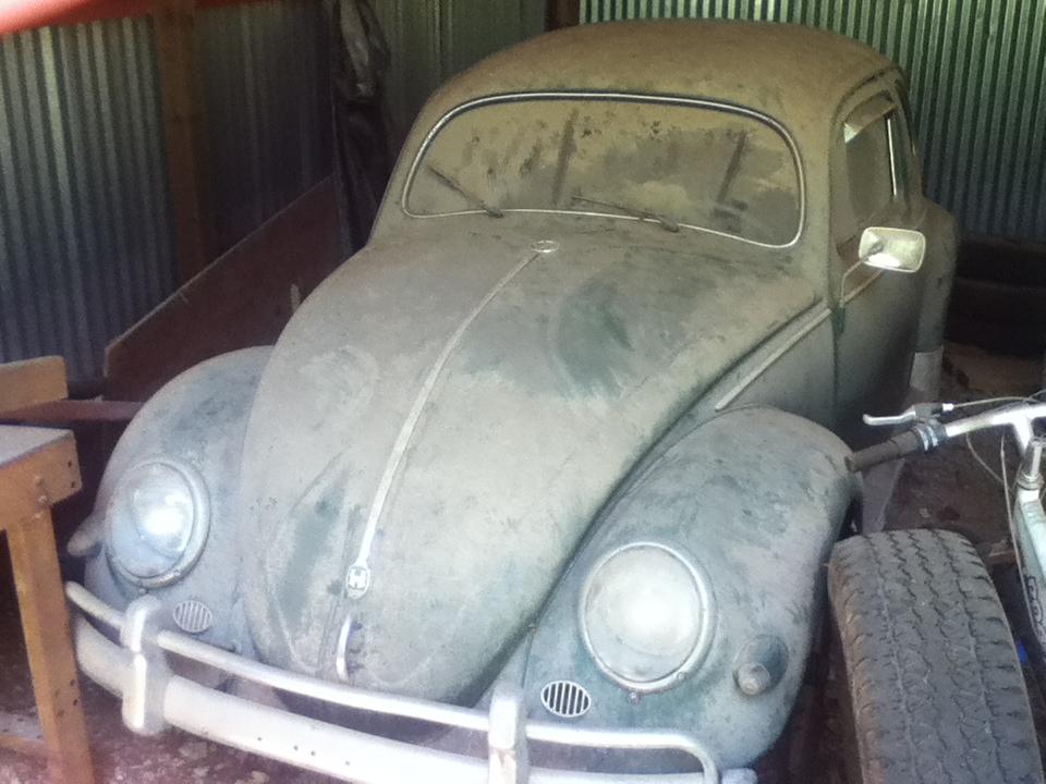

Hello Samba. I have had this car for a few months. I wanted to learn a few things before coming onto here and asking stupid questions. I have lurked this site for a couple of months, and now, I am ready to present this project that has landed in my lap. Also, I would like to apologize ahead of time for the plethora of unorganized information I am about to spit out at you guys, also for any stupid questions I may ask, they will crop up.
In short, I inherited a 1957' VW Beetle. Most of it is original from what Grandma tells me, and it was well taken care of. That was until my Ex-uncle tossed the poor thing into a shed about 25 years back.
I found her like this:
So me and a friend of mine dragged her out and put her in my Grandma's garage, which thankfully had a free side for me to put her in.
I apologize for the awful pictures up to this point, after this I had used a much better camera.
Now, she looks like this.
