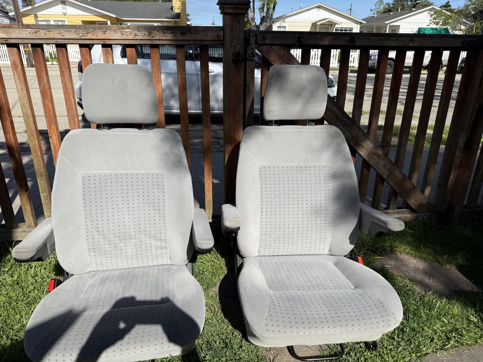

PostPosted: Sun Apr 27, 2025 5:55 pm    Post subject: Re: Replacement front seat foam? Reply with quote
bikes! wrote:
bikes! wrote:
The seat base foam on my van has 701881375 B molded into the underside. The foam measures 520 mm wide by 540 mm deep, without the fabric covering. All the aftermarket options which sell in the US and list dimensions are 520 x 520 mm.
After (much) more consideration and research, I ordered VW original parts, 701881375C, as that seems to be current. They are coming from a VW dealer near Berlin (who has them in stock but won't sell outside DE) to a friend of mine in Germany. Then he will ship them on to me here in CA. Might be some time before I get a chance to test fit them.
I also ordered a set of seat heaters which, while not OE, have VW like switches and should look stock to most observers.
More in a few weeks or so.
It's been more than a few weeks, more like a few months. Getting parts shipped from Germany is not as easy as it used to be.
I have the new foam seat bases and they appear to be OEM parts. I'll post pictures later. Also have the seat heater on hand now too. Refurbishing the front seats is now my winter break project. more to come...
Following up - albeit a bit late - the OE foam fit perfectly and made the seats much more comfortable. I washed the fabric with Woolite in the tub while I had them off the seats. Made the seats feel like new!
On a trip to Germany back in January, I went to visit a shop which specialises in refurbished Recaro seats. And placed an order for a pair. Took over 4 months for them to arrive.
So, the stock seats which I'd spent a lot of time and money restoring are now for sale in the classifieds here. The new foam shipped from Germany and seat heaters cost more than I am asking for the seats. I have learned a lot from the group and would like pass these on to someone here who needs better seats.
VWs past: 66 Kombi, 76 Westfalia Camper, 17 GTI; present: 02 Eurovan MVW, 17 Alltrack SEL & 19 Golf R
