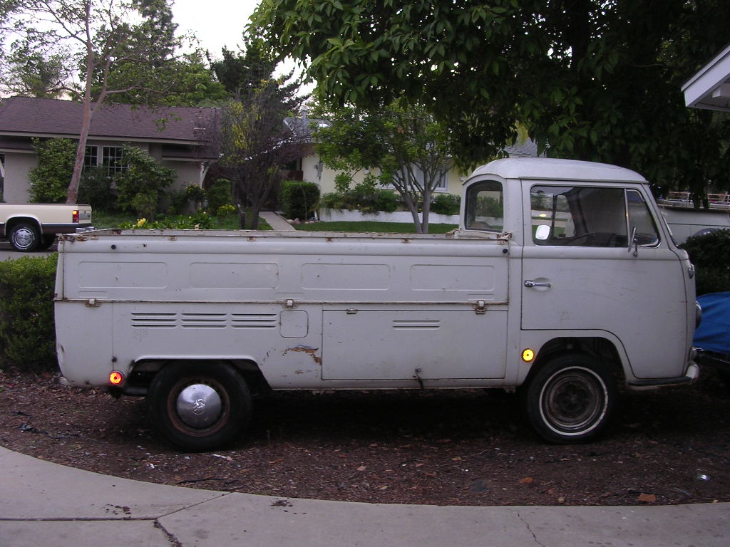

Ooops! Embarassed Forgot to post a pix:
Here's what I had to begin with! Rolling Eyes

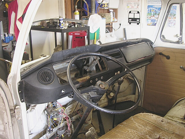

So I'm getting the turn signal lights nearly figured out, but...
I got a funky in-dash lawnmower type starter switch and want to install a correct one on the column. Found one at the scrapyard but for the life of me I just could not remove it! Mad
I could have hammered the damn thing out but since I need it, I didn't want to ruin it in the process. So just HOW is it you remove the starter switch WITHOUT having a key!!!! Confused
