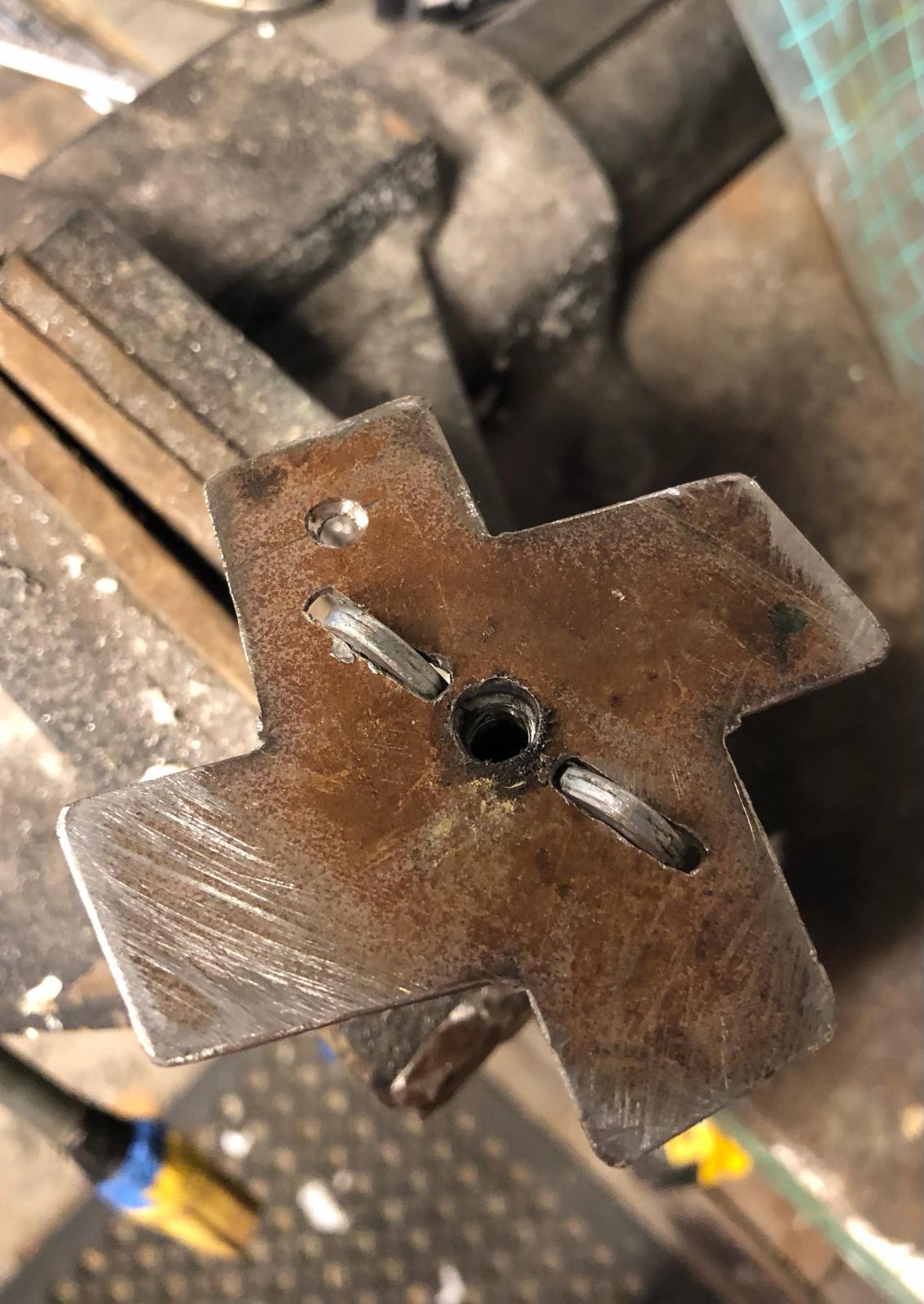

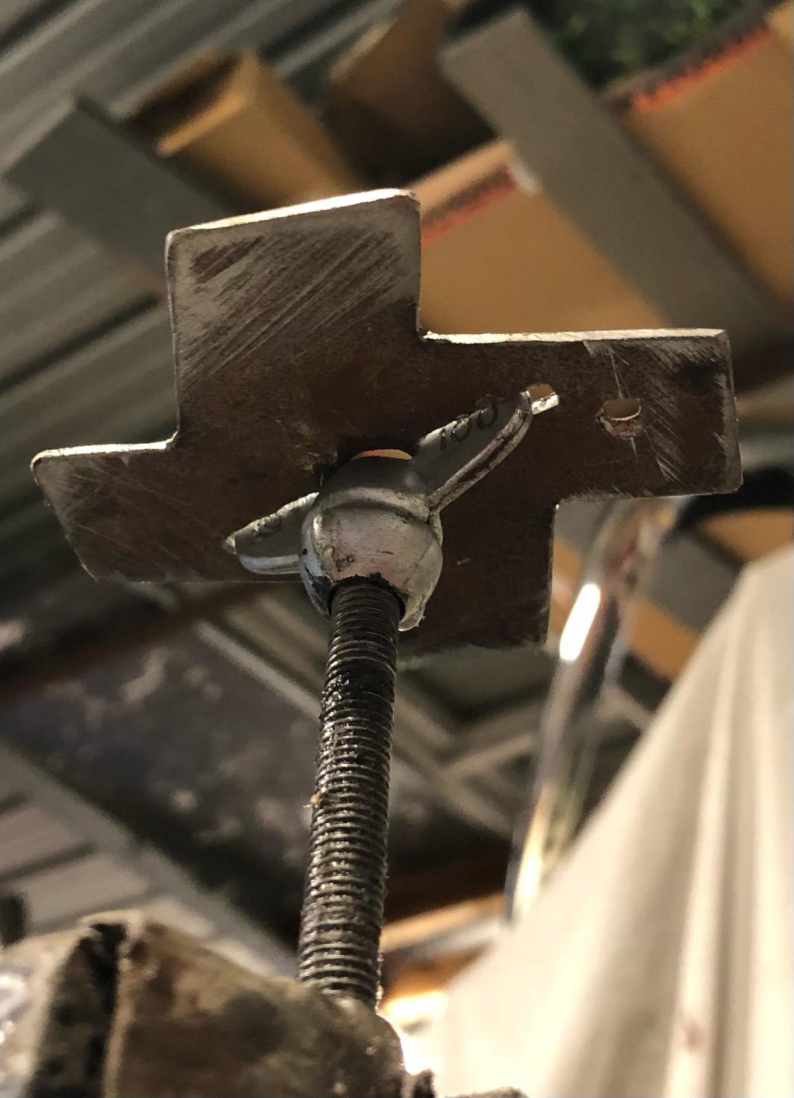

If you've ever struggled (or are about to struggle!) with that hard to reach clutch cable adjustment wing nut underneath your car.
I've made a free download pdf template which you can use if you have a spare scrap of steel and are handy with a drill and grinder
(it does not have to be neatly cut out to work, see my photo's !)
