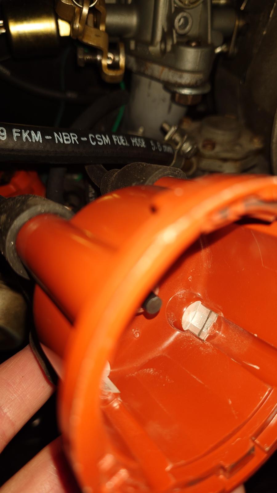

What might cause this uneven scorching of the terminals on a new distributor cap?
This is the cylinder 2 terminal after a 15 minute test run...
The scorching looks unusual to me and particularly so compared to the other terminals that all look relatively clean like this...
It's a 1600 dual port engine with an original Bosch SVDA distributor. I've just changed the oil, points, distributor cap and rotor arm before taking it out for it's first run of the year (the drive train has been out while I repaired the transaxle).
The engine developed a slight missfire under acceleration as it came off choke that worsened as the engine warmed up. By the time I'd done a few miles and got it fully up to temperature the missfire became severe and an intermittent 'sneezing' backfire developed.
I will do a proper tune up over the weekend when the weather cools down (we've had freak heatwave here), but in the mean time I checked the parts I've changed.
Pulling the distributor cap, I noticed that the rotor arm seems to have 'clearanced' some of the plastic. I wiped the plastic dust off before I thought to take any pictures. More significantly, I noticed that unusual scorching on the cylinder 2 terminal. The other three terminals look OK.
I checked the distributor shaft in case there was any play that might cause the rotor arm to come closer to that terminal than the other. There is no lateral play (there is about 1mm up/down movement).
The cap and rotor arm I recieved from the supplier have slightly different part numbers to my old ones. (New cap = VK1061, Old cap was VK106BE. New rotor arm = EVL0851EF, old arm was EVL085BE).
The cap was seated correctly, as far as I can tell.
Any ideas why that terminal would show unusual scorching after just a few minutes? And could it relate to the worsening missfire?

pretty obvious the rotor did that ? but was it a cap made off center ? looks like its like one or the other . was the rotor installed all the way down and in the notch ? my guess is likely cheap aftermarket parts ? ill often pay more for Bosch .

silicone grease (dielectric grease) put onto the tip of the rotor helps protect it. That is just a trail of arcing. I suspect that when the industry went from brass embedded caps to aluminum embedded ones that type arcing became more prevalent.

Just seems weird that only one of the contacts is like that and there is such a clean swipe and that I had an increasing missfire.
The cap I took off had the usual marks on the contacts and the other three terminals new cap look to be forming normal marks.
The parts are all Beru. I didn't cheap out.

Put the old ones back on and try it. If it runs fine... chuck the new ones out.

Some of those Beru parts are made with aluminum inserts. Yours might still be fine. Buy a Bosch one and see if it fixes the issue. If not you have a good spare.
