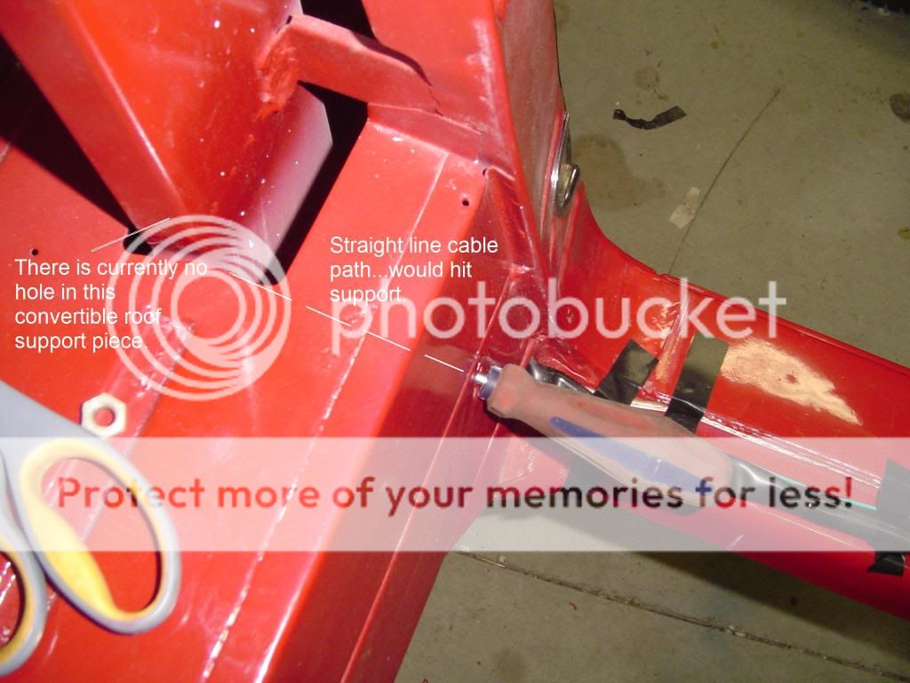

Here's my latest quandry...it looks like the cable will have to bend sharply around the convertible roof support bracket. Either that, or I'll have to drill a hole in it. Am I missing something here? In the photo, I've inserted the screwdriver and drawn a line to show what I mean.
Any suggestions?
Disc
Joined: September 24, 2009
Posts: 638
Location: Europe
Disc is offline
PostPosted: Tue Oct 12, 2010 11:05 pm    Post subject: Reply with quote
We have a '67 CV and that roof support piece have a hole for a cable!

PostPosted: Wed Oct 13, 2010 5:15 am    Post subject: Reply with quote
There should be no need to drill a hole.
It's there already. You just haven't found it yet.

PostPosted: Wed Oct 13, 2010 8:24 am    Post subject: Reply with quote
Sure enough, there it was...it seems like a plug of Bondo Dust, paint/primer fumes, dirt and god knows what else had formed, perfectly hiding the hole. I rooted around in there with a longer screwdriver than the one in the picture, and voila.
Thanks guys.
