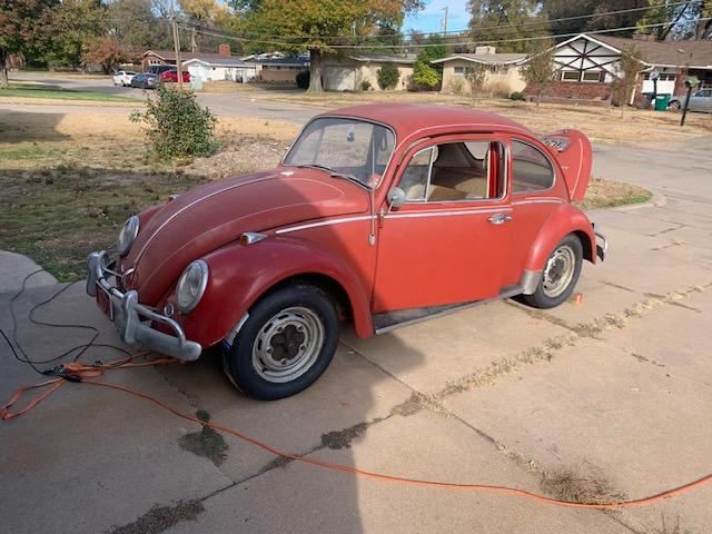

This thing is like a time capsule. Filled with artifacts from the early to mid-70s. PO walked away from it, never to return.
The engine looks like it was showered in oil, and never cleaned up. It's all down the apron and all over the underside of the deck lid.
Looking for some educated guesses as to what caused this. Keep in mind, this is my first VW, and I am not a mechanic.

Is the motor seized? Can you put a wrench on the pulley nut and turn it by hand?

Sorry, should have mentioned that. Unbelievably, it turns by hand. Oil is still in the crankcase, but just enough to register on the low end of the dipstick.

All that oil might have help preserve what looks like a wonderfully original engine. I bet that thing will start up with little effort. Once you know it’s running you can start tinkering with it. Oil change, adjust valves, cap, rotor, points, clean out fuel lines, etc. Once it runs, move on to brakes. Not super cheap exactly, but you can do it in intervals.
If you get a Bentley manual (eBay, samba.com) you could probably do it yourself (or with a friend).

Replace all rubber fuel lines (including under the tank and next to the tranny, before you even crank it!

No worries there. Just about anything that isn't some type of metal or glass is going to have to be replaced. I am hoping a good portion of the electrical system can be salvaged. I don't mind keeping it 6 volt for now.
Amazingly, as of this writing, I believe I won't have to replace the pans or channels. It was kept extremely dry. There will be surface rust to deal with of course.

My 61 still has the original engine that sat since 1979. It still turned and fired up with no trouble. somehow I believe that old waxy, sludgy oil from the 60s and 70s preserved the inside from moisture taking over.

As long as the preserving layer of oil wasn't from the big holes in the top of the the case from the thrown rod... Embarassed

I decided to pull the plug today. Slow as molasses. It took a few seconds for it to decide to start flowing, but eventually a tiny little strand started.
Eventually several strands would flow, but all very thin and in no hurry.
This was more than two hours ago and I'll bet it's still not finished.

One morning a few weeks after I bought my '65 I went out and saw an oil slick under the car. The fuel line under the tank had basically dissolved after 50 years and let all the gas out of the tank. Lucky for me it happened in the middle of the night while I was asleep and the car was NOT in the garage.

It wouldn't hurt to put the plug back in, put some diesel fuel in the crankcase, and slosh it around (rock the car from side to side). Let it sit over night, drain it, and refill with the cheapest oil you can find. Slosh it again, drain it, and refill with good 15w-40.

The oil cooler seals might be shot causing the oil leak.
Will diesel break down the hardened, waxy oil that is caked in the oil fill, air cleaner, etc?

Yeah, diesel or kerosene will help clean it up, but there's no easy/quick/mess-free way to clean up an engine. Lots of hand scrubbing!
Take a peek down the cylinder tins and fan shroud and make sure you don't have any mouse or squirrel gifts. That will cook an engine pretty fast. The oil everywhere might be from oil cooler seals, oil pressure switch, or the rear pulley from excess blowby. If you get a good compression check on the cylinders and don't find any obvious external leaks I'd just clean it up and enjoy it Smile
