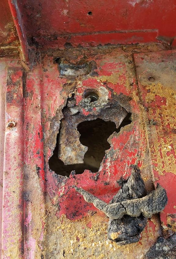

I removed the shag carpet from the front of my '69 bus and on the passenger side I found a very un-SoCal-bus sight:
There's some black goo that was placed over the hole, and there's some on the driver's side also. The hole on that side is minor, like a bolt-hole.
From below:
That's mostly undercoating, not rust, the rust seems to be pretty limited. The bracket wiggles a bit and I'm sure it's not safe to use. I've found some replacement pieces that can be welded in, with a huge variation in price - from $31 to $129. None of them state the thickness of the steel used in the part.

call Brian at Washburns in Orange John . they fixed by bug pan . thats what they do is weld VW and Porsche !!! they dont do cheap work , they do good work LOL
he might like to source his own sheet metal as not all venders quality is the same , he will know . i was gona buy new jack ports but he had originals cut out of bad pans to re use .
https://www.thesamba.com/vw/classifieds/detail.php?id=2564870
you may get buy with a smaller repair than the whole piece if you could find a welder . Washburns likes BIG jobs LOL

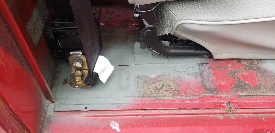

Well, what's in there are after market seats. There are 4 bolts inserted into the sliding rails on the bottom of the seat that then mount on the steel bars that have been welded onto the seat stands. I don't know how the Scat seats mount, they're "semi-universal" mounts.
I have modern style after market seat belts from Jbugs in there, they mount nicely into the existing mounts.
I suppose I can find a set of VW seats, order the replacement VW seat rails from buttysbits.com, grind off the steel bars and have the new rails ready to weld in place. Like it's all that easy. I found some old seats at the OCTO event (but didn't buy them), and a guy who will fix the springs and reupholster them, it'll cost about $1300 total.

Maybe just cut out the whole seat belt mount, then weld in a new piece of steel, drill a hole and tack weld the back.

I was able to take the bus to Washburn's and Brian got it fixed up beautifully. He even welded in the seat rails that I had riv-nutted in place.
