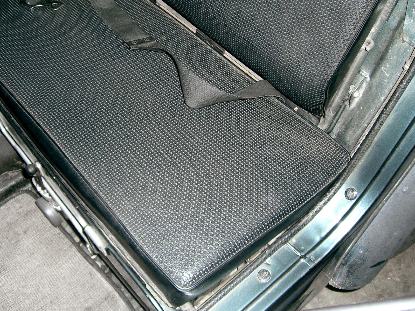

Sorry for the misunderstanding.
I have used Beetle (low back) seat covers seat covers successfully.
On my '74, which I owned for 37 years, I used "basketweave" seat covers, even going so far as to use the the same basketweave material on the rear seats.
If you look carefully at the owner's manual, you will notice the basketweave upholstery in the early European civilian model used for the manual's illustrations.
The basketweave material is much nicer than the original smooth vinyl because it doesn't get as hot when parked in the sun, and it keeps your butt from sliding around.
The coconut fiber, coir, what ever it's called... from the Thing Shop has always fit perfectly for me. It's the stuff to use on the front seats.
