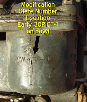

The Modification State Number was on the bowl of the carburetor facing the fan shroud up until mid year 1966, then it moved down to the base flange next to the throttle arm.

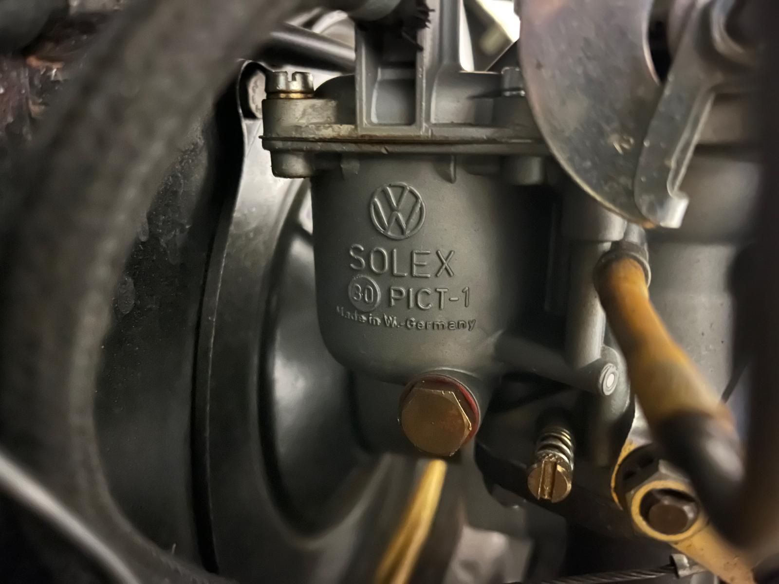

I had VolksBlitz build this carb for me, not sure I will try to get a look at the shroud side.

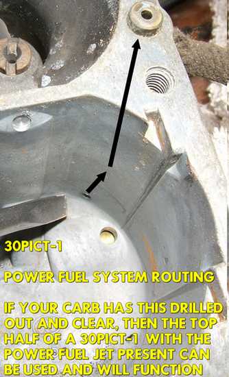

You were talking about what might cause such a carburetor to suddenly lose its top end... and if it has a power fuel system, that can be a cause. However, it's not terribly likely to "just happen" though, the 28PICT-2 example I gave, I found out on my test run with a very nice clean looking carb I got at a swap meet.
If the mod state number is facing the shroud, then you know it's early, so it has to be a 1300 carburetor that lacks the power fuel system. AND if it was born as a type 1 carb. VW 47 didn't have the power fuel system, but VW 45 for the 1500 bus and VW 46 for the 1300 Ghia, they did.
And s for the VW 47, it did lack it... when it was new.
While the Beetle 1300SP carbs lacked the power fuel system, the carburetor lower half still as the holes drilled in it for it, so if you change the top half of the carb with an equipped version, then boom, you suddenly have power fuel system. (and potentially, bad fuel economy if you still have the large main jet)
You can just take off the air cleaner and look down and the brass nozzle for the Enrichment (power fuel) is just under the vent tube for the bowl.
And some examples of the Modification State Number.
