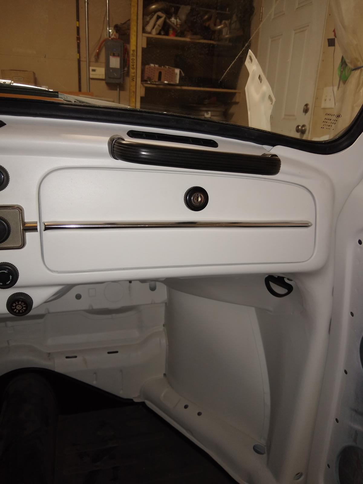

I believe what you need for the defrost vents are available at Heritage VW in the U.K..
https://www.heritagepartscentre.com/uk/113819635-d...ight.html.
https://www.heritagepartscentre.com/uk/111255483-centre-dashboard-vent-trim-for-metal-dash.html.
I used Type 3 knobs (shorter) for the fresh air controls, headlight switch, and wipers when I took off the dash pad of my 70 sedan. I also modified the glove box door and made a new ashtray front to better fit the dash opening. I also sourced a dash handle from a 1200a/Sparkafer from England and a 58 right side grill (no gas gauge, with a trim strip that fits better than a late model).
https://www.thesamba.com/vw/forum/viewtopic.php?t=414792&highlight=steel+dash+glove+box

Thanks, Danpa, for all the info. I'll check into Heritage and some other European sources as I'm in Greece. That's a nice looking dash you have there!
