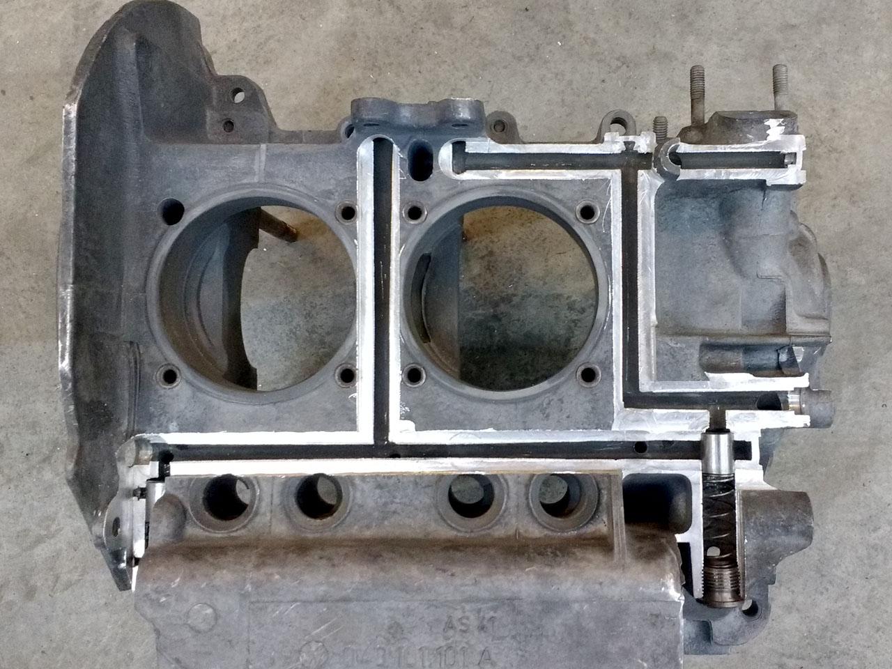

PostPosted: Sat May 10, 2025 6:16 pm    Post subject: Re: High Oil Pressure Reply with quote
Tho it's not a great angle, in this cutaway pic you can see the two holes drilled horizontally through the flywheel side oil plunger bore.
the upper hole exits into the case between the lifter and the pushrod tube.
the lower hole goes into the inside of the sump about at the oil level
