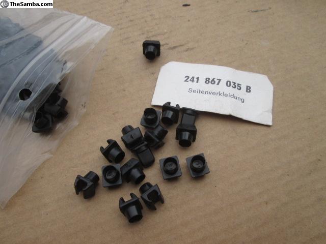

early (68-72) back shown in classifieds
Plugs from Alan Schofield 211-853-615
late (73-79) back showing the tabs that snap into the holders that snap into holes in the nose (from classifieds)
Late (73-79) clips that snap into the holes (from classifieds)

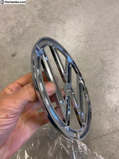

Here you go. These emblems are very low quality. They're 2 piece. Threads are on a ring on the back side, which is just glued to the emblem portion. The one I pulled off my bus was one solid piece.

that emblem is aftermarket and designed to be held on with washers and a nut. You'll have to find a way to seal it from leaking if you use it. I will tell you that it is very hard to get a nut into the area that a nut needs to go. When ZBed built their spare tire product that used the stock hole, they used a stainless blind rivet and center that was hit in to lock it. The reason was how hard it would have been to use a bolt and nut.
