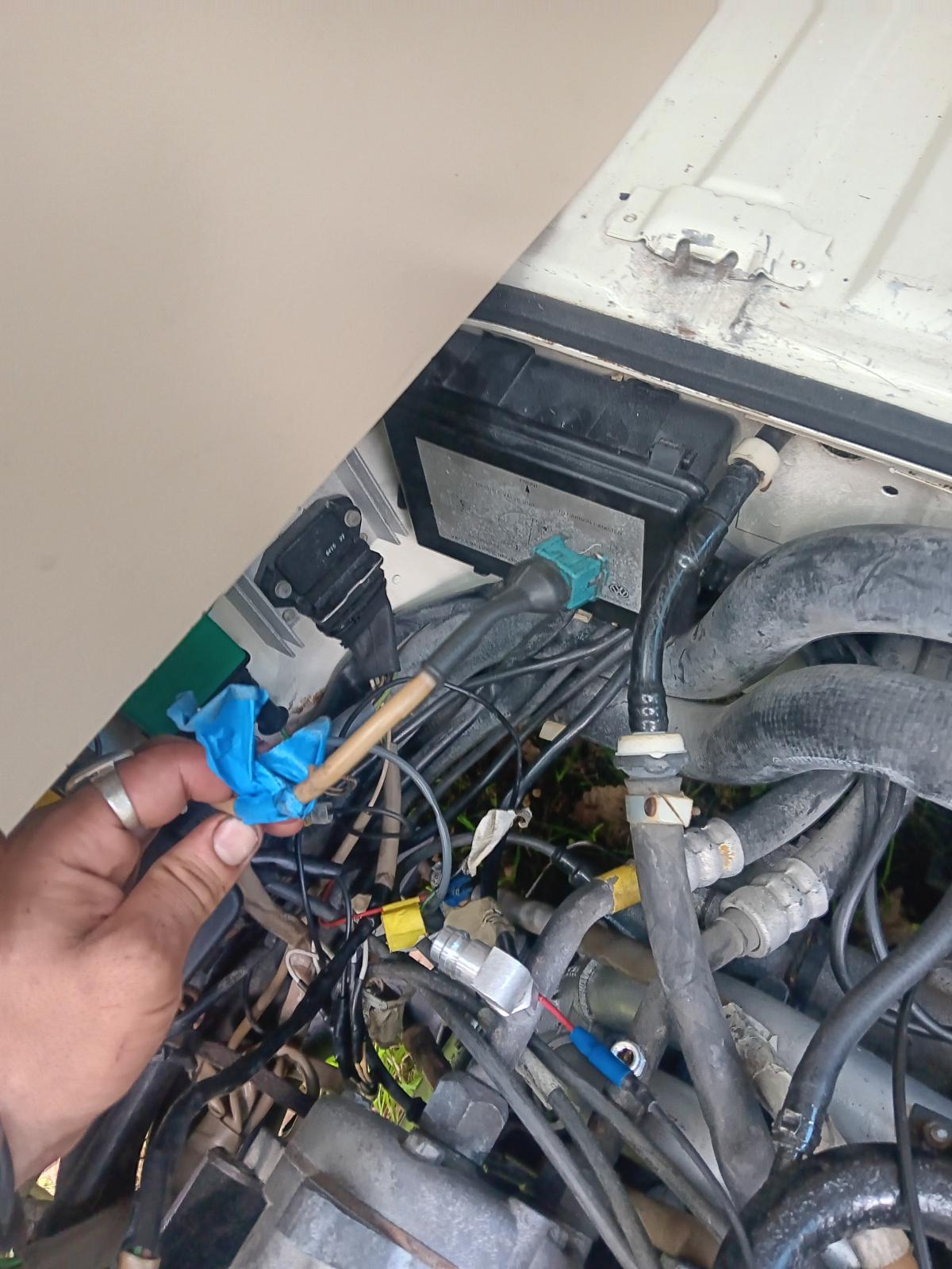

I need help locating where these 2 wires go, the client brought this to me to hook everything up and he totally forgot where everything went, it's been a minute since I've messed with a waterboxer

The blue one is for the Temp2 sensor on the thermostat housing.
The green shielded wire is for the OXS.
