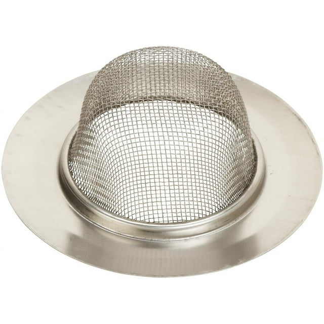

Kitchen sink screen can be made to work.
https://shoptalkforums.com/viewtopic.php?t=146663&hilit=kitchen
https://www.walmart.com/ip/Mesh-Sink-Strainer/3807...mp;veh=sem
