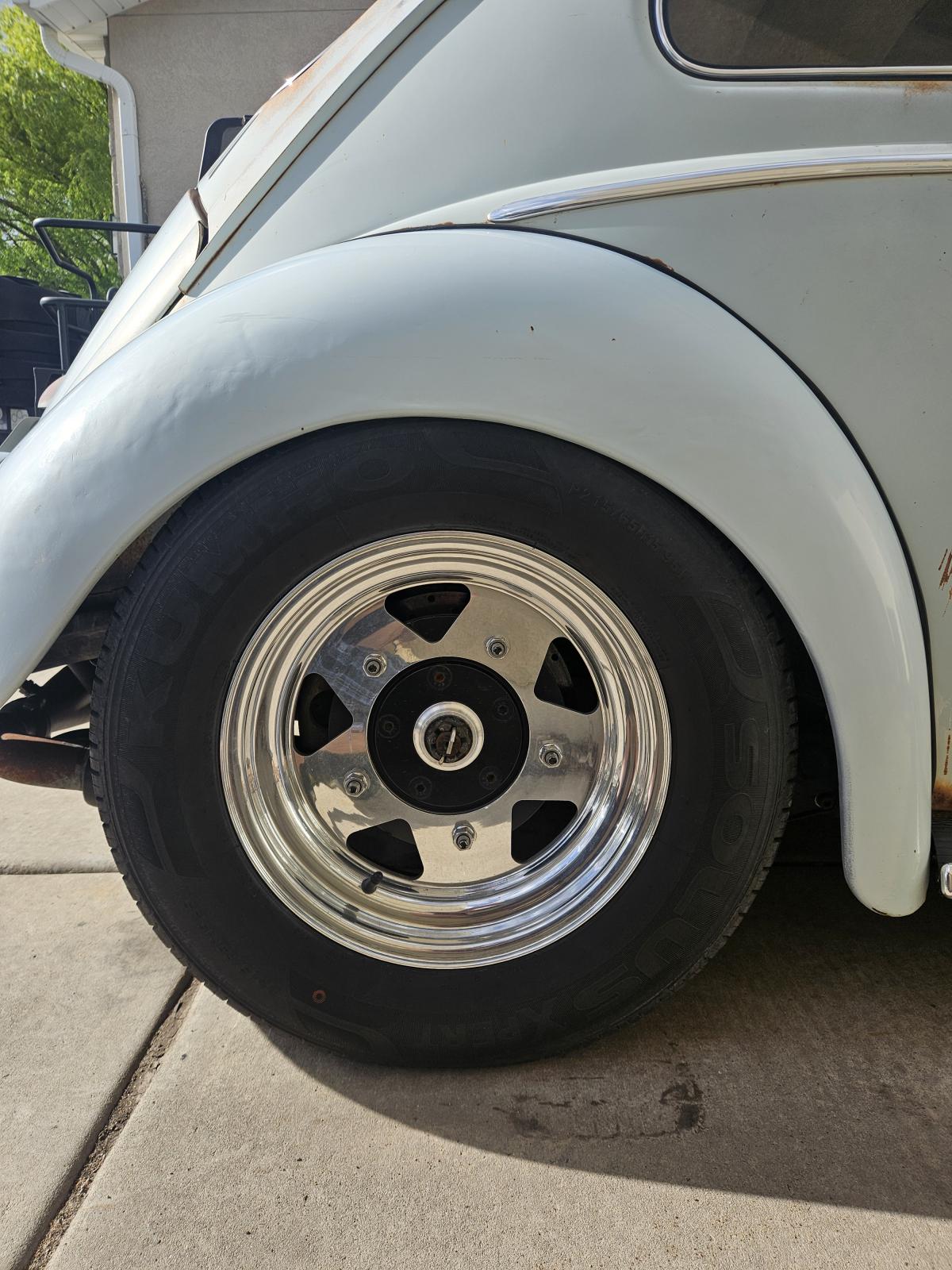

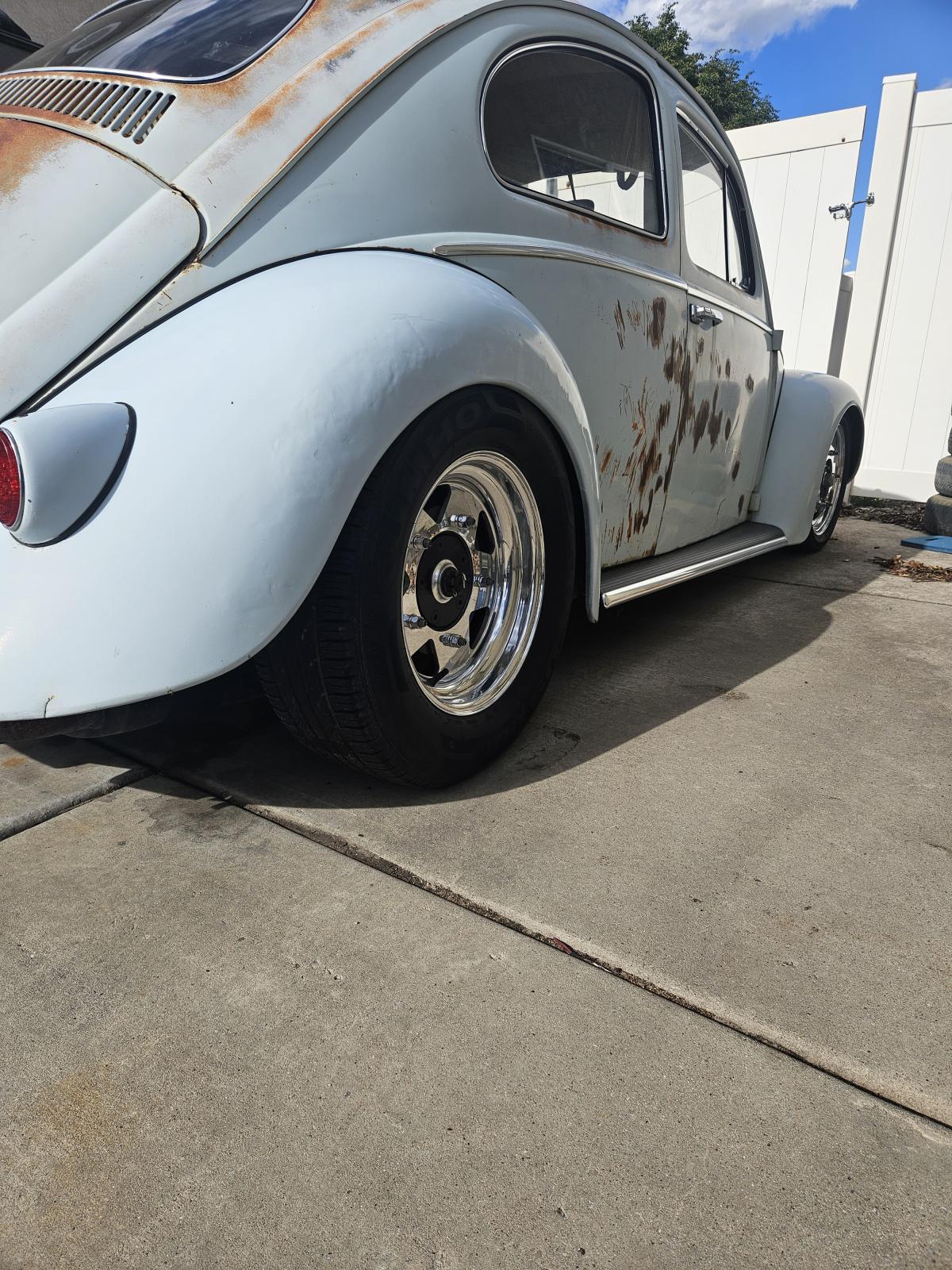

I just bolted up a set of 195/65-15 tires with 5.5 x 15" 8 spokes to the rear of my '59 bug. There is a huge gap between the top of the tire and the fender.
I don't want to buy them and then not have them fit and be stuck with them, but would a set of 215/70r15s fit and close up the big gap?
Just doing the math, there is almost a 1 inch difference in width between 195mm and 215mm tires, but with 70 series there is about a 2 inch difference in height. The gap between the top of the tire and the rear fender right now with the 195s is easily 3 inches.
There are also 215/65r15 tires, which are 1 inch taller. I almost think they would still leave a nasty gap, so that is why I have my eye on the 215/70r15s.
Any suggestions?

You're still going to have the gap no matter what tire you put on as you are not addressing the the gap, and changing tire only effects the height of the rear of the car, doesn't lower the car towards the wheel (which would narrow the gap).

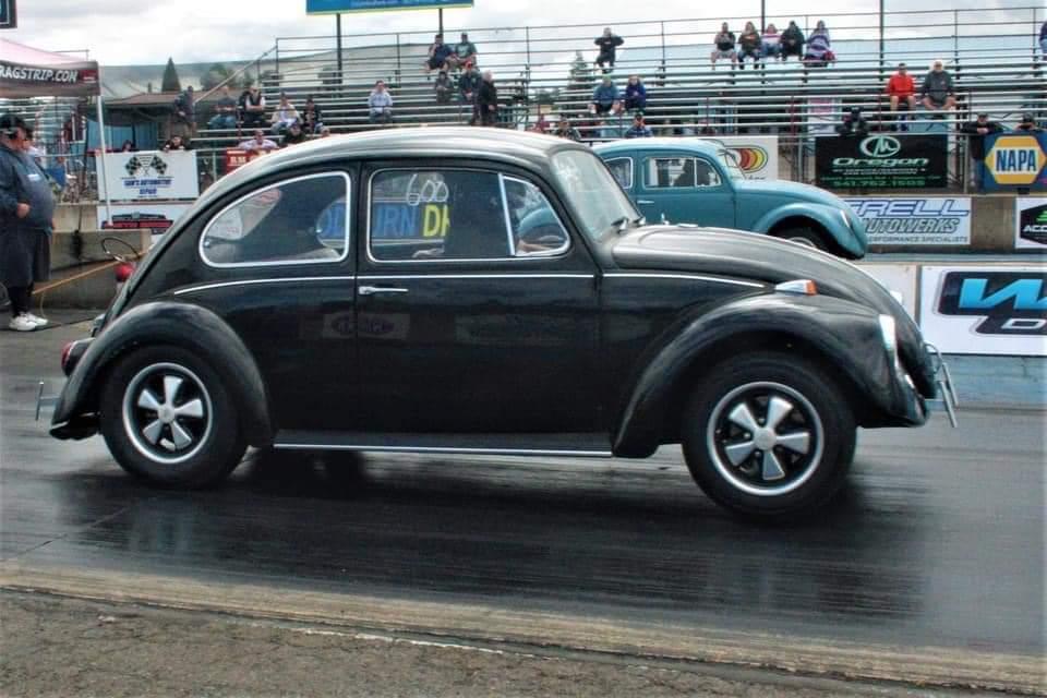

Sounds like you have a stance issue. Fix the stance. I have 215/65r15s on my lowered short axle bug. They are a tight fit.
I don't want anything taller on mine.
I want anything taller on mine.
Chip what wheels are those on your car? What is the offset in the rear, and what size tire,wheel and offset do you run in the front?
Your car looks sweet with that combo.

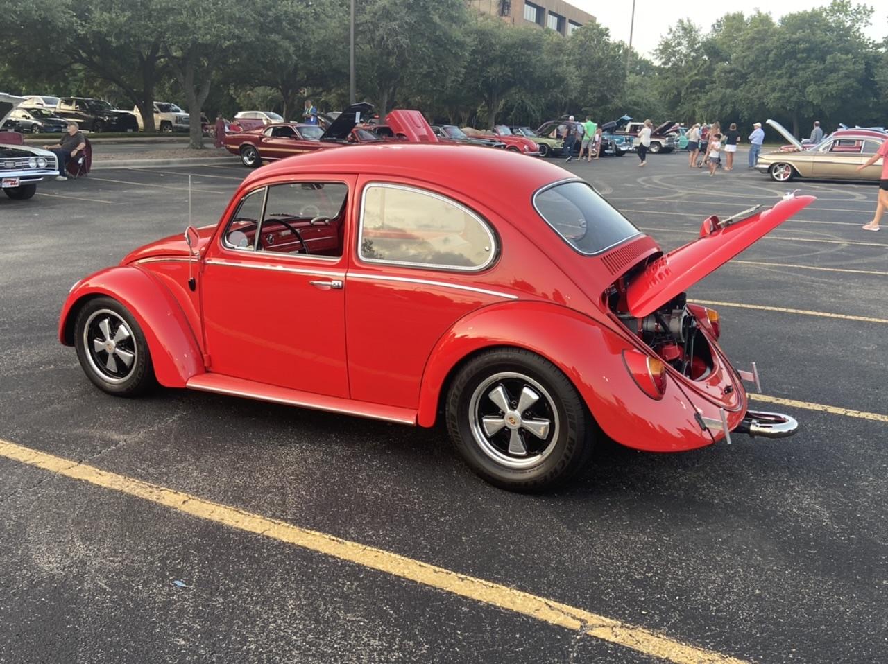

I run M&H 215/65 DOTs on my short axle 67 bug. I also have CB Performance race strength brakes. It is a tight fit. I have 19mm wheels spacers to get the tire off the stock spring plate.

Yes, I run the Super Pros on my 2276 with a Web 86C. I run the Berg 42 x 46 grooved venturis. Current jetting is 170 main, 210 air, F11s and 60 idles with 110 idle air holders. My elevation is 1400 feet static altitude.
Mark at Strictly Foreign built this gearbox for me. He started with a aluminum Rhino gusseted case, super diff, dual billet side covers, Berg axles, German 4.12 r&p, 3.78 first gear with 091 idler, 2.06 2nd, 1.48 3rd and a 1.14 4th.

I'm honestly not sure on the offset, but I think pretty centered in the rear on a 6" wheel, maybe 3.5" bs. The fronts are 0 offset 3.5"s with 145/65r15s. 3"narrowed beam, lowered spindles, Airkewld BAD series brakes front and rear. The wheels are ERCO Star Cutouts.
My car was re-geared for the drag strip many years ago, so it actually really likes/needs the tall tire. It has a mostly stock 1600 in it. Your 40hp may struggle with a big tire. Build that big engine! Is your pan IRS?

205/65’s in rear and 185/60 in front.
6” wide rims front and rear…not sure 215’s will fit 5.5” rims
