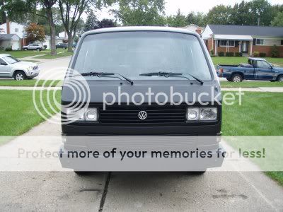

HeftySmurf wrote:
Check this out just got it done Line-X all around and the entire front... New GoWesty bumpers tooo Twisted Evil

PostPosted: Mon Aug 22, 2011 7:32 am    Post subject: Reply with quote
After seeing this in the gallery....ugh im thinking i might just do the lower section.

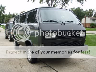

PostPosted: Mon Aug 22, 2011 10:23 am    Post subject: Reply with quote
Here is the picture of my Westy.
Steve

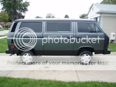

PostPosted: Mon Aug 22, 2011 10:27 am    Post subject: Reply with quote
And a close-up.
Steve

PostPosted: Mon Aug 22, 2011 12:47 pm    Post subject: Reply with quote
what product did you use in that pic?
stevey88
Joined: January 16, 2008
Posts: 1317
Location: Fremont, SF Bay Area
stevey88 is offline
PostPosted: Mon Aug 22, 2011 5:38 pm    Post subject: Reply with quote
U-Pol Raptor. From TCP Global
