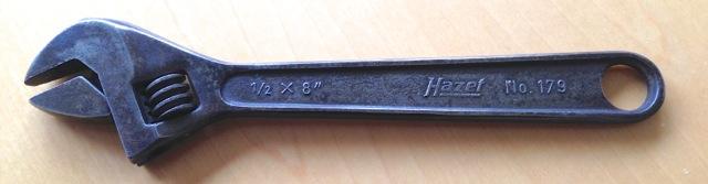

You won't need to remove the steering wheel as a roadside repair.
10, 13, 14, 15, 17 possibly, but any more wrenches than that, is just silly to cary with you unless there is no home.
VW didn't as a general rule use any 11 or 12mm, but there are exceptions and possibly non-standard hardware has been added since. What size are they? the generator could be 19 or 36.....which nut did you put on it?
I use vise-grips for that.
#1 tool, vise grip wr5,
#2 wr10,
#3 six in one screwdriver
#4.... not sure, maybe, a hammer

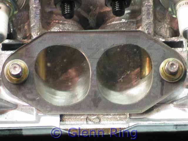

3/8" if you use Jet Nuts on the intake and exhaust manifold studs.
Just saying.

gt1953 wrote:
Gotta love that old Penncraft wrench.
Hey - bought that metric Penncraft set brand-new in 1971 for my "mechanic's helper" job at Tim's Auto Repair in Phoenix; I couldn't afford Craftsman or Snap-On.
Those Penncraft wrenches are lifetime-guaranteed, and I've never broken one, or lost one, in all these years. Hmmm - I wonder how JC Penney would handle a warranty claim.....
