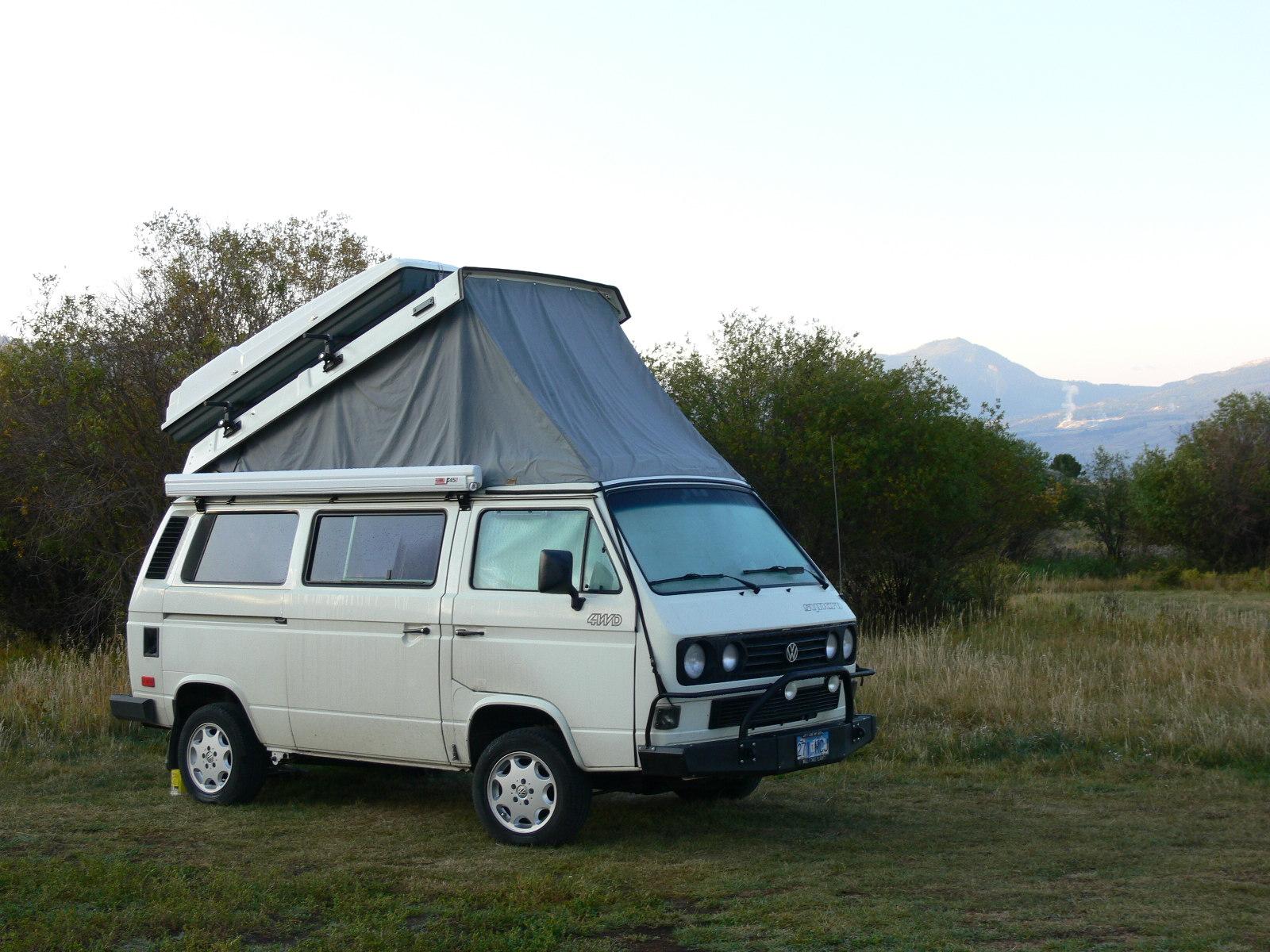

We've been using the GW wasserstopper for a number of years. Definitely nice to have for keeping the canvas dry. Little bit of a hassle to put up, a couple of the snaps are kinda hard to reach.
On windy nights it can keep you awake flapping.
Here it is when dry.
And wet. Canvas was bone dry.
Just stuff it into a garbage bag and spread out to dry later.
