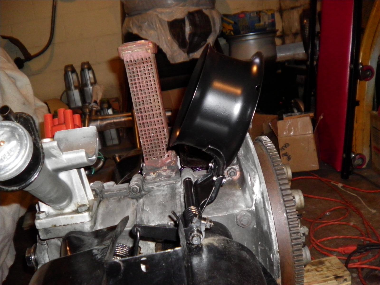

Is it possible to use fixed open flaps combined with the throttle ring thermostat setup? Or will it interfere with the operation of the ring mechanism?

I've installed both systems over the years but it's been a few years & I don't have the memory like my younger years. I've included a photo from around 5 years ago when putting my stale air system on current 40hp. It seems the linkage will be obstructed by the fresh air flaps although I've never tried.

I mocked it up with the fixed flaps, and it does seem like it will interfere. I was just wondering if it was possible. Also, I found an old thread on here and sent a PM. He has some fresh air tin he will sell to me.
