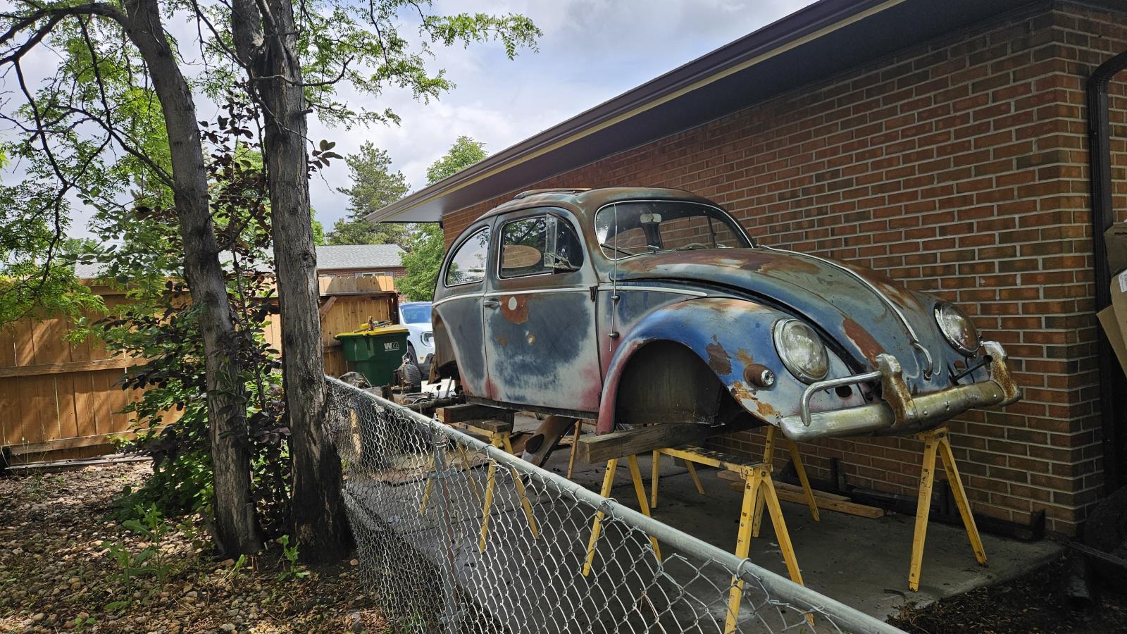

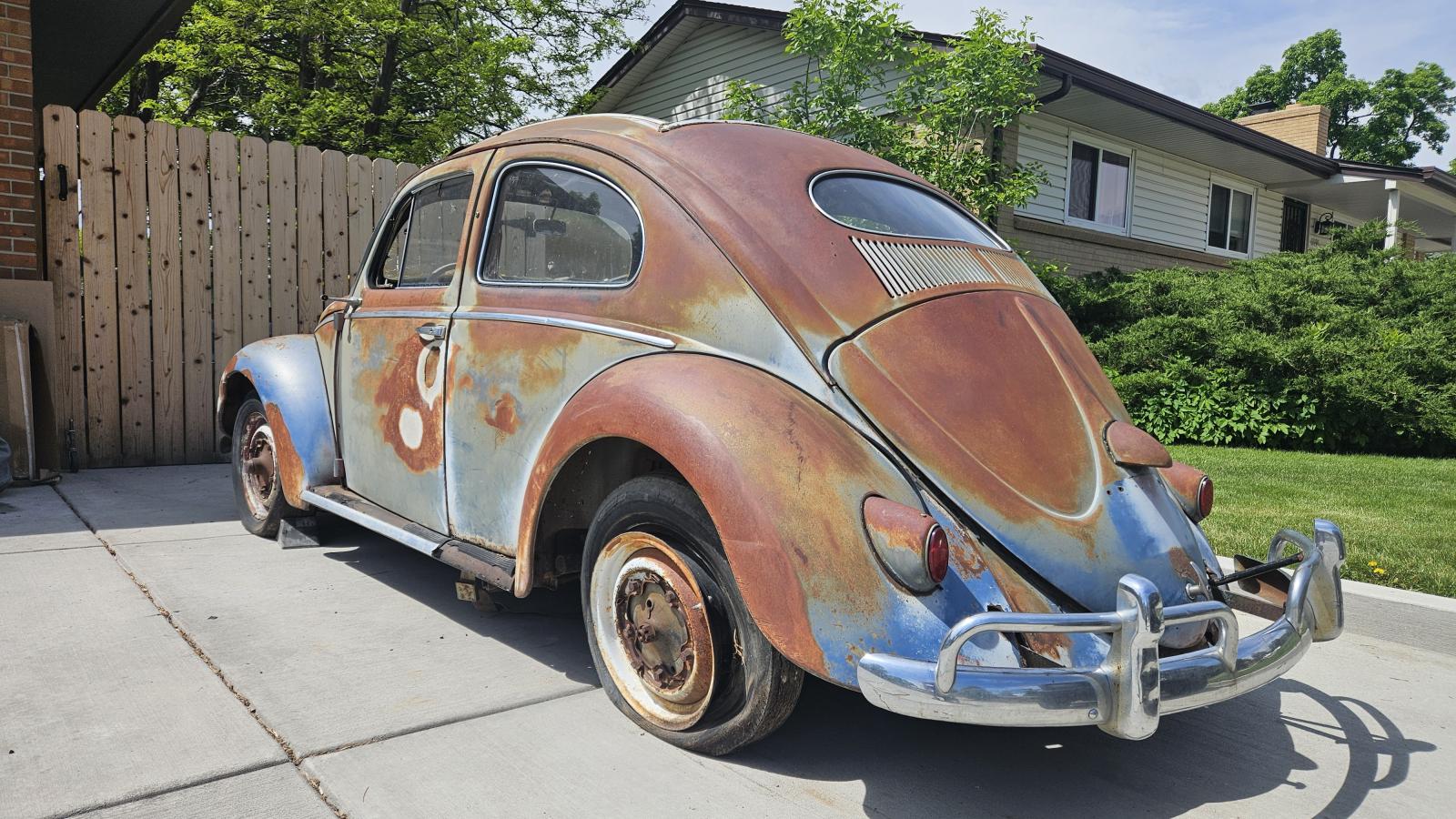

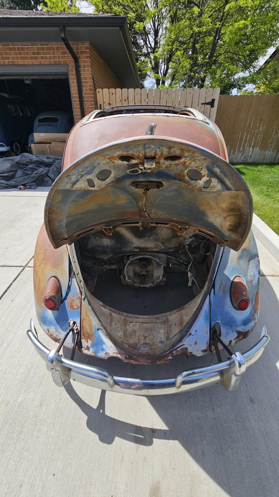

Came across a new project.
Only months after finishing a three year restoration on a 56 ragtop, here's my new 55 ragtop.
I'm still thinking about what my plan is going to be. I'm easily a year of work ahead of where the 56 was metal work wise... So there's that. Or perhaps I just get it road worthy and drive it as is ... I'll sleep on it.
The last four photos are of the 56 I just finished restoring.

Depends on your assessment of how much rust has affected the structural integrity of the floorpan/heater channel IMO. Looks like a lot with the sunroof gone. Great find!!
And excellent work on the '56!!

Heater channels don't need to be replaced. Floors should be replaced but I think I can get away with just a patch on the right rear side.
I'll jack up the body slightly to clean up, replace the seal and get some por15 in there.

Body is off the pan. Today I took the front axle and transmission out and scrubbed the pan w degreaser. If it ever stops raining here I'll apply phosphoric acid and then por15 the whole thing ... After I replace the rear pan halves and weld up a few small holes on the driver's front.

First, I'm enjoying this thread so thanks for doing it.
Second, this is a cool photo:
gzaharatos67 wrote:
I see it's behind your fence but I still imagine driving by and seeing that in someone's side yard and being "Holy shit, an Oval!"

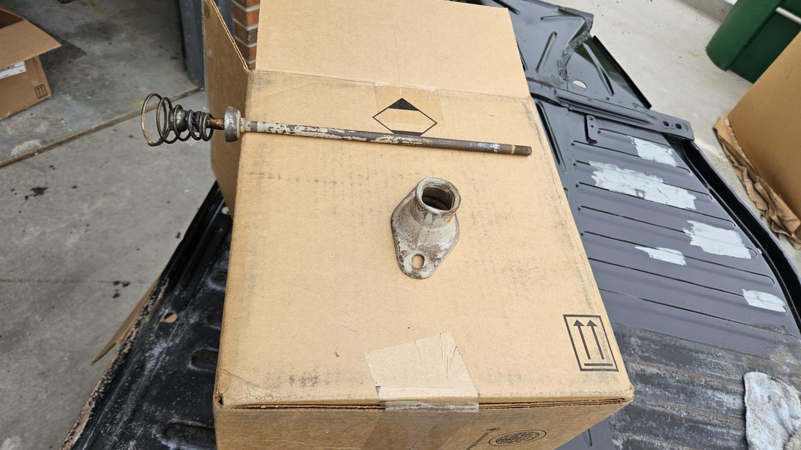

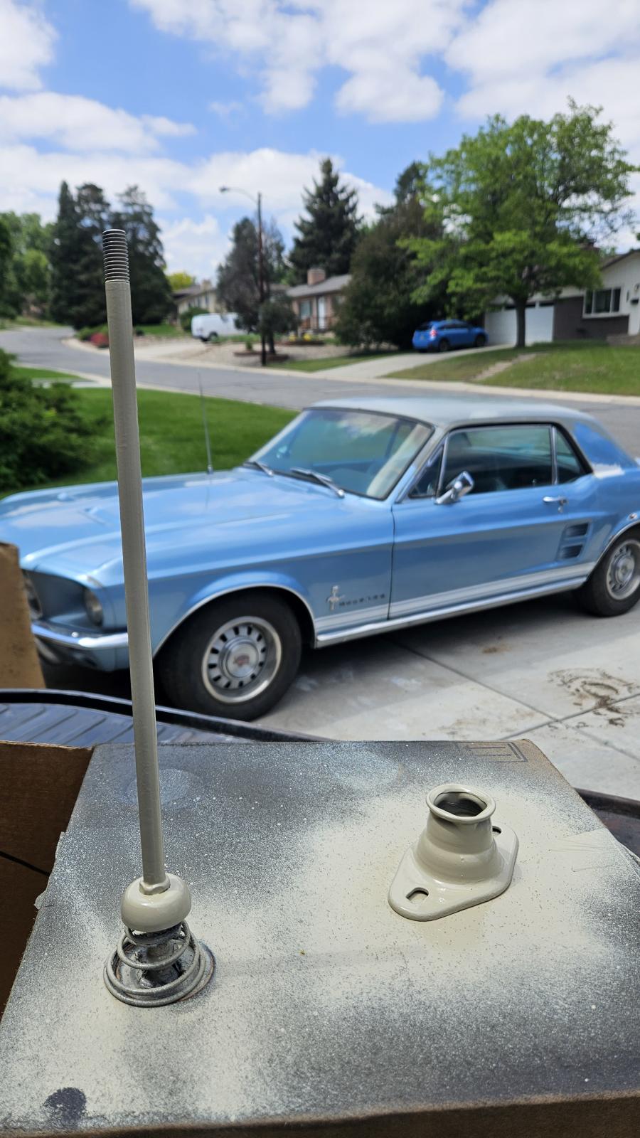

One thing I've learned from this hobby over the last 25 years is that sometimes you just need to see a small victory... In this case it meant painting the shifter and base L75 beige after some rust treatment. Although I think the base gets painted black ...
I also split the case on the 36hp to see what was inside ...

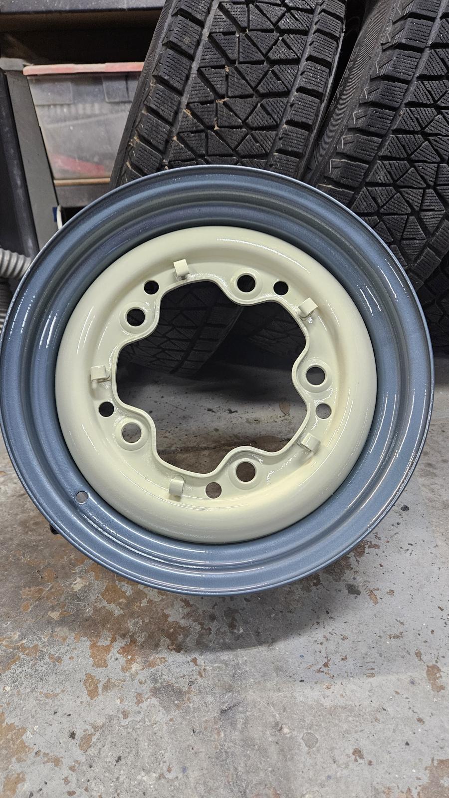

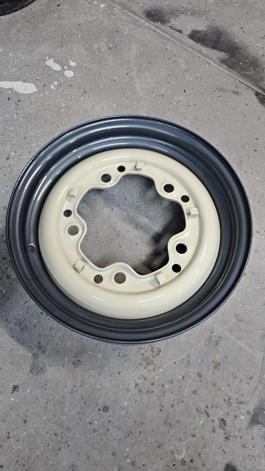

I removed the apron, measured up and cut out the right rear quarter. I'm pretty happy with how curving the bottom lip on it came out. I made it match the factory curves, being tighter in the rear and a wider gap as it goes forward.
I also painted two wheels ....sometimes you just gotta see color, hah!
Strato silver and pearl white (which I hope is the correct inner color ... It's certainly different from silver white).
