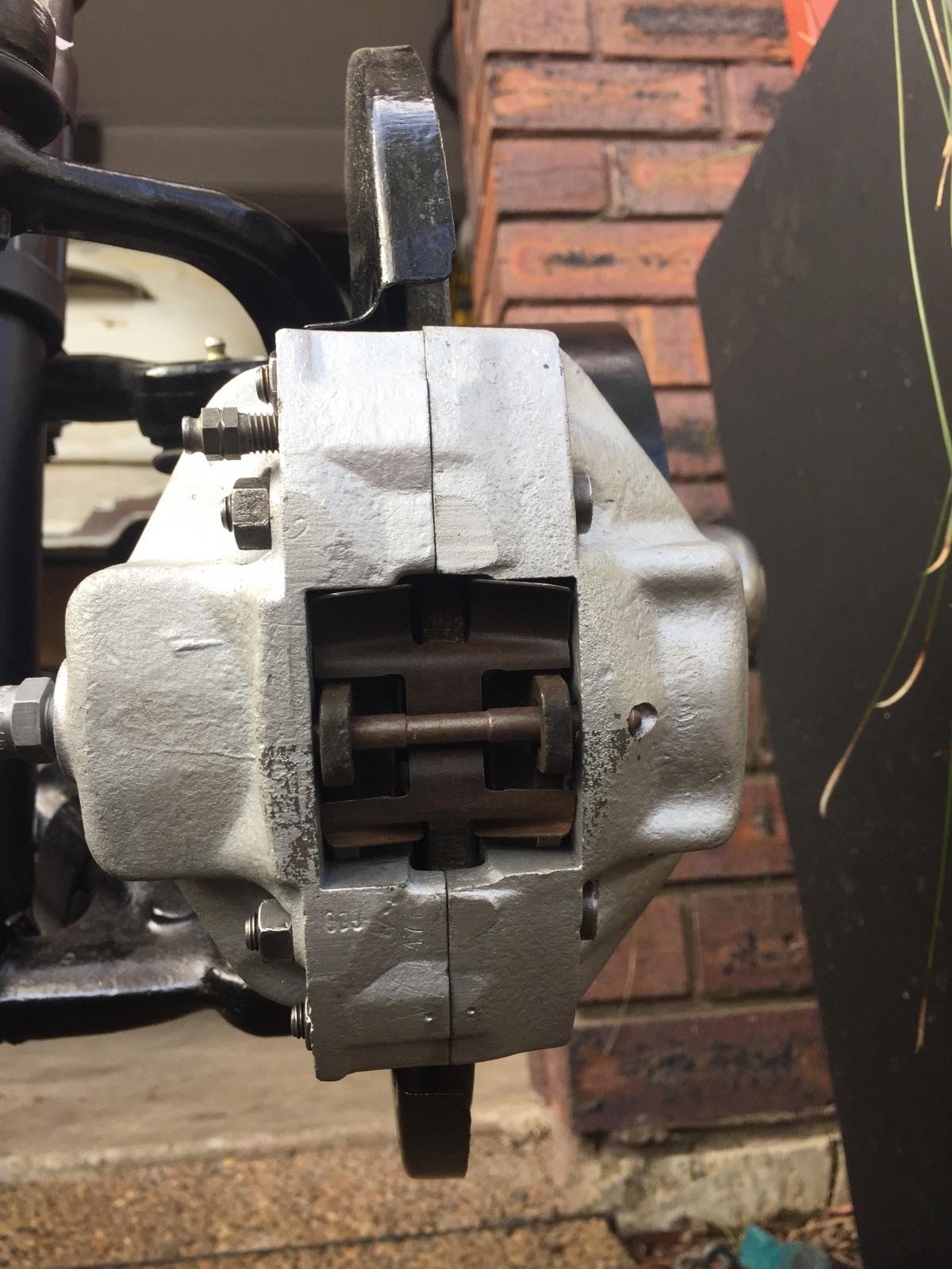

Re the brake disc callipers being seized.
I split and rebuilt the callipers myself. If they are ATE callipers (which they probably are) they aren't difficult to do.
A lot of websites say to "never split a calliper" but these are very simple devices.
The only issue is that there are small O rings that separate the two calliper halves.

Regarding the callipers, I was tempted to split and rebuild them but they are from a later model going off the part numbers. I decided to just put the whole thing back to stock 67 setup and use new parts and not used bits from auto jumbles like the PO did.
Re the callipers, mine are the original 1968 RHD Euro beetle imported to Australia. They are the single retaining pin ATE callipers. Later models had the two retaining pin. Was the '67 the same i.e. single pad retaining pin?

According to the maintenance manual I’m using there were two types of calliper fitted to the car, one by Girling and the other by ATE. The ones sent to me by my chosen VW parts supplier were branded classic line/JP Group parts but that’s not to say they built them. They are the two pin type and they look very nice.

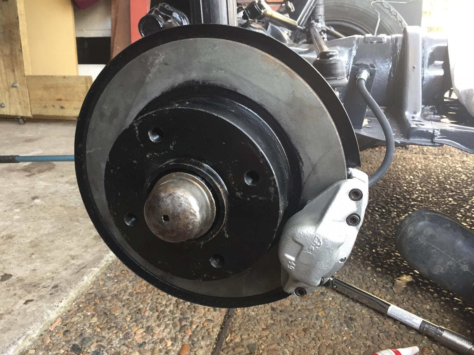

Some good news at last! I’ve finally got the brakes working and I can safely drive the car Very Happy
After replacing the front brake discs, callipers, brake pads, wheel bearings, brake hoses, solid brake lines, the master cylinder, the grommet in the MC and the gravity pipe from the reservoir to the master cylinder we managed to get the system bled yesterday and after a short test drive it’s apparent the brakes are very effective indeed!
I confirm you that EU 67 and 68 beetles with 1500 engines have a single pin ATE caliper.

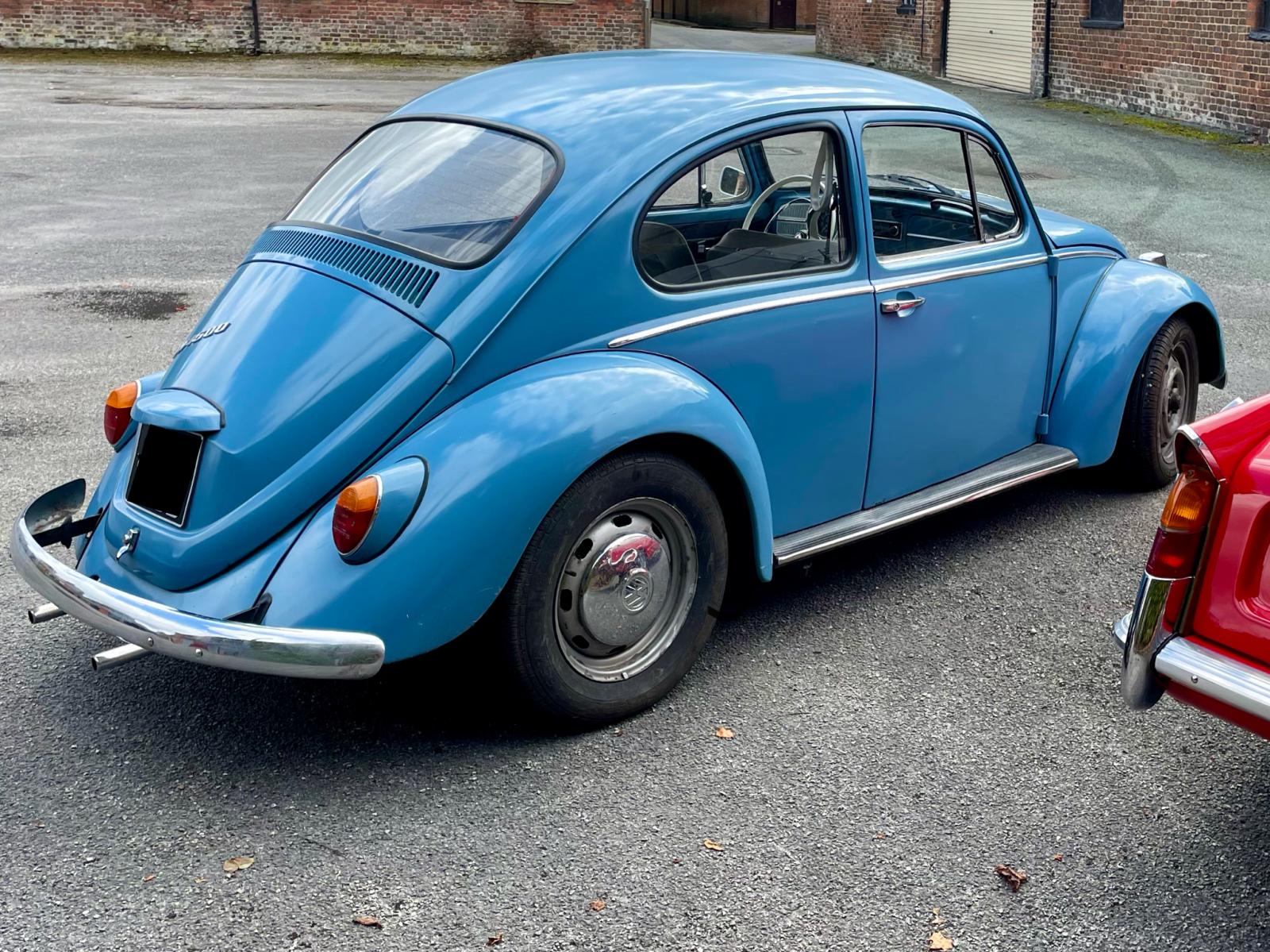

Finally got a couple of pictures for you to see.
Here is “Oddball” in his current condition, just about every bit is wrong!
Pictured next to the first car I ever restored and I’ve had since I was 16, my 1971 Triumph Herald which is actually a custom car tribute as she’s fitted with a Vitesse Race Engine and various other speed parts.
Oddball is a cute little fellow and I’m sure in time he can be gradually returned to how he should look!

What a cool looking car! Love it!
I'm super interested I how your car will look, because despite being from England, I've been out here in the states now for 13 years and only know US spec stuff. So a euro spec 67 will undoubtedly look different from a US one...case in point below a Pic of me aged 5 with my dad's 67 (or maybe a 68 ) certainly not a towel rail front bumper like the American ones!
Keep posting, this car is going to be ace!
