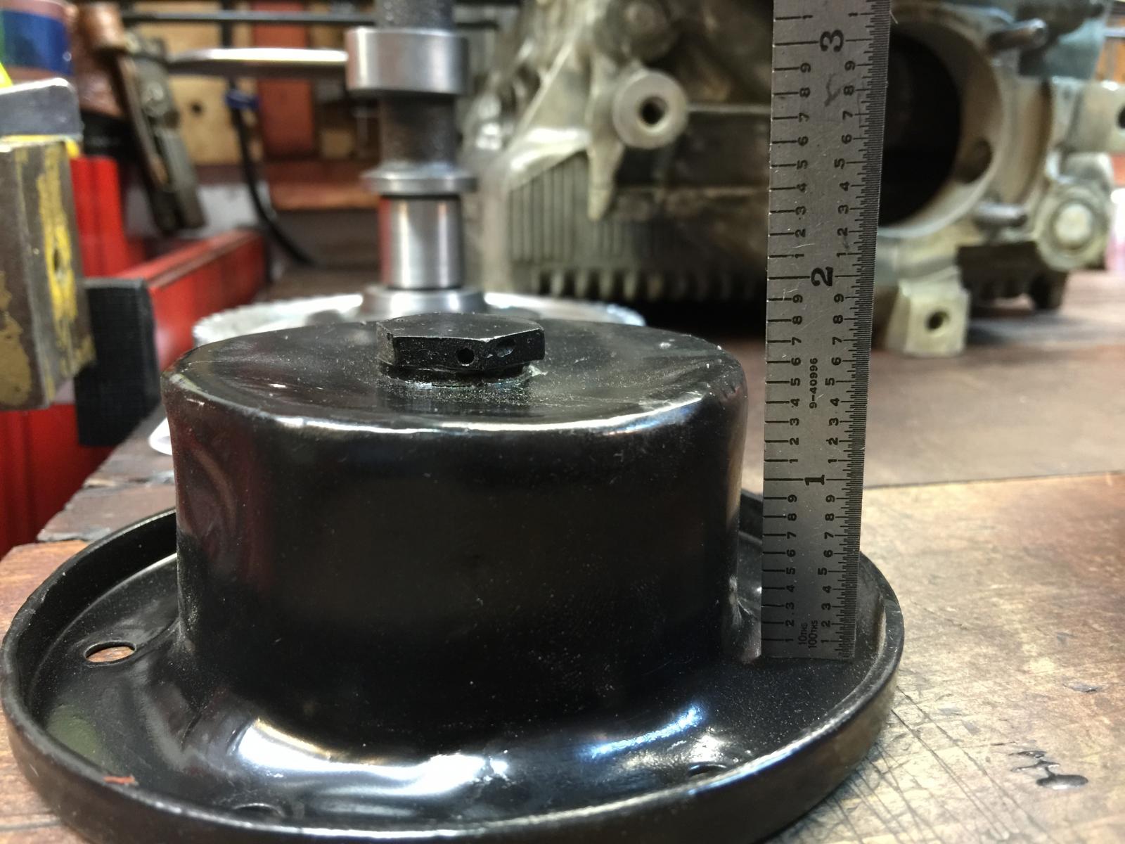

115.00 for a sump plate? Maybe for a show car, the kind with mirrors underneath the kind that get trailered to the shows. As for the chrome it would help to lightly abrade the sealing surface where the plate meets the gasket. Pay attention to the magnetic plugs sometimes they can ride high an restrict the oil suction especially if the strainer is missing.
Here’s an oldtimer not pretty but it works.
