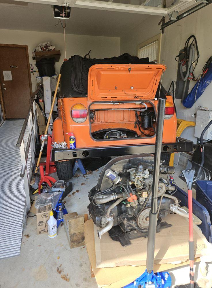

Just wanted to give you all an update... I got my tow bar, had a local iron working weld on safety chain points (that I bought from Amazon), and towed it down about 80 miles a couple of days ago.
Took a little bit to get used to, and city start/stop/bump driving certainly feels a bit unnerving, but once up at higher speeds (never went over 50 though), it worked very well.
I DID up disconnecting the battery because I thought it would go dead on the trip since the car was "on". Worked well, and now I have the bar and magnetic lights for future use if needed.. All cheaper than renting a U-Haul car transport one way!
Thank you all for your guidance.. I look forward to years of working on this car and gaining knowledge from all the pros here... I'm truly amazed at the knowledge floating around here... I just don't speak the language yet!
Photo of the setup attached.
