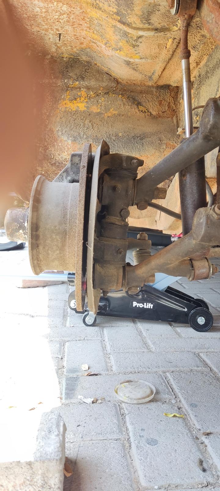

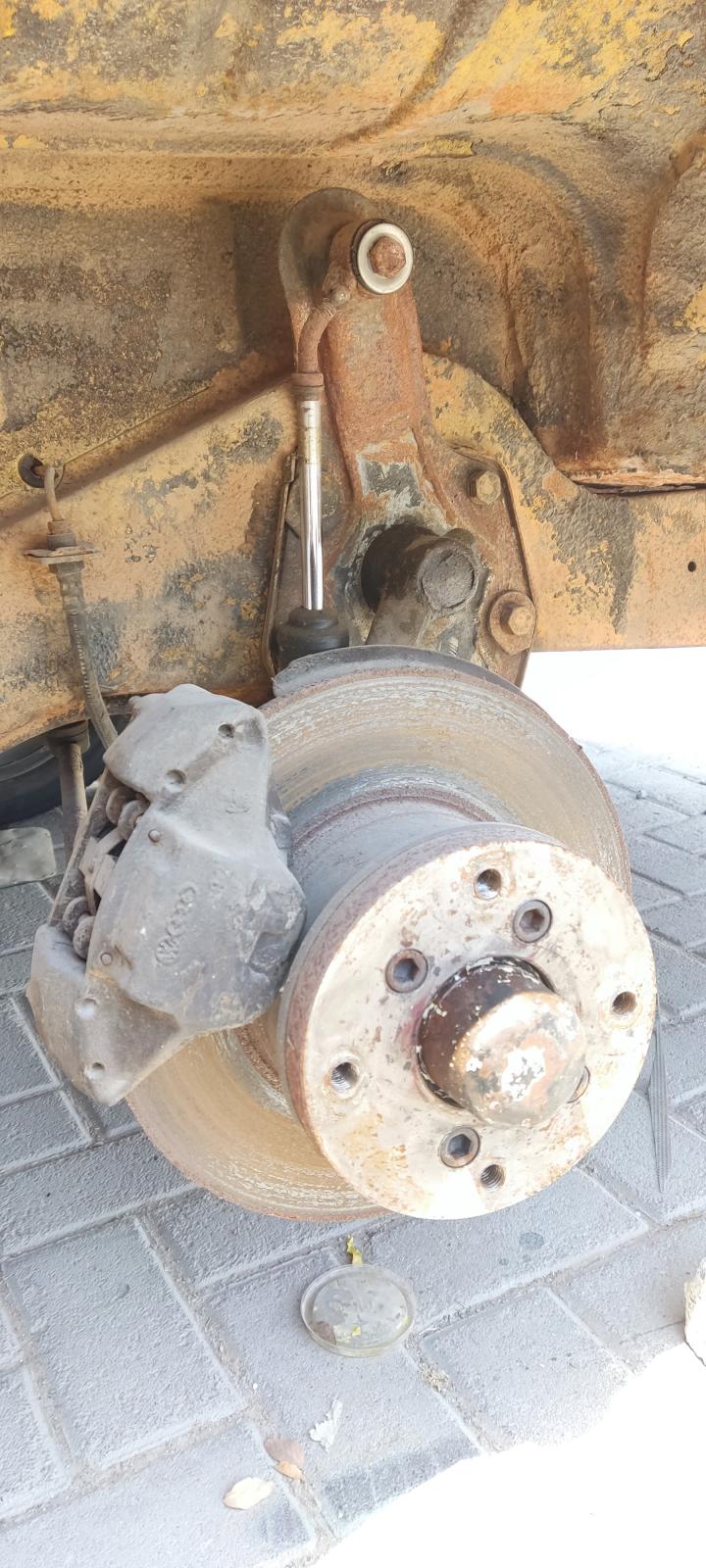

PostPosted: Sat Jun 07, 2025 12:39 am    Post subject: Re: Brazilian Split 4 stud wheels Reply with quote
Thanks everyone. I got the wheels off today. The front is using spacers and looks like discs have been drilled to accept the 4 stud pattern? Rear is this a beetle transaxle? No engine in at the moment so back is sitting higher than it usually does.

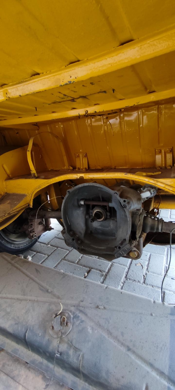

Redfox2020 is offline
PostPosted: Sat Jun 07, 2025 12:59 am    Post subject: Re: Brazilian Split 4 stud wheels Reply with quote
Rear drum set up

PostPosted: Sat Jun 07, 2025 4:41 am    Post subject: Re: Brazilian Split 4 stud wheels Reply with quote
I don’t know what that is but I do know I would be terrified to drive that. Please just get stock brakes back on it and ditch that mess. Wheels look cool but not at the cost of your safety.

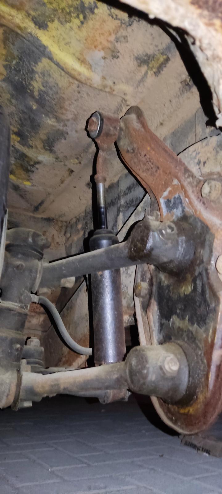

PostPosted: Sat Jun 07, 2025 5:14 am    Post subject: Re: Brazilian Split 4 stud wheels Reply with quote
What the bubba??? Shocked
Someone just got on about it with this one. I'm diggin' the front shock.
Yeah, ditch all that crap and start over with the proper parts.

PostPosted: Sat Jun 07, 2025 12:29 pm    Post subject: Re: Brazilian Split 4 stud wheels Reply with quote
Yes quite shocking. I'd intended to overhaul the brakes and suspension but not sure if it's worth salvaging that front beam or starting from scratch?
Any thoughts on the rear setup? Scrap it and start again? Ideally would like to convert to disc brakes.
