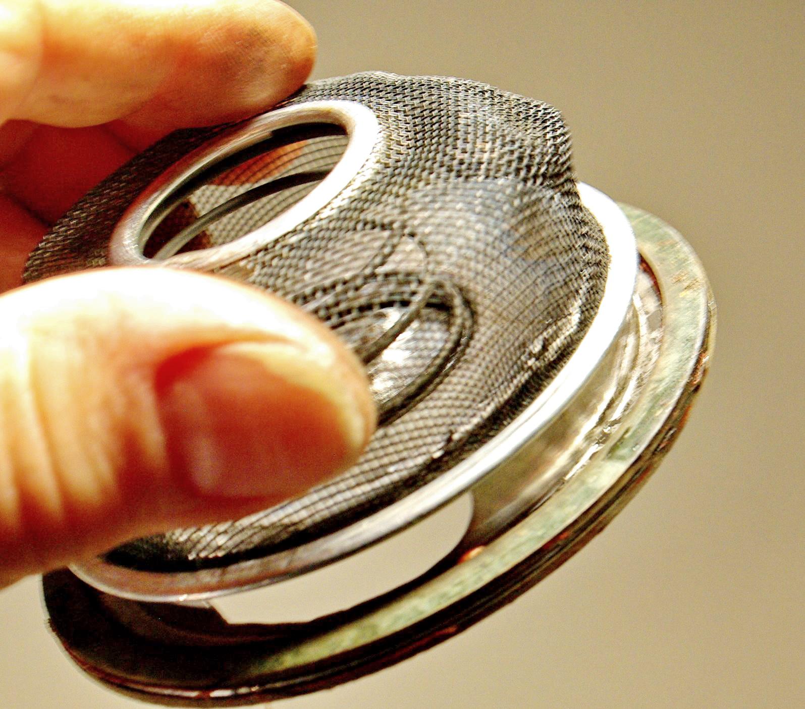

Here is what it looks like when the gaskets are adhered to the strainer.
I would have to look in my log book but this probably has 30k miles on this gasket set or about 9 oil changes...no leaks.
Ray

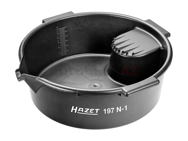

or you can just cut the filter open each oil change and see anything that is passing thru the system. Filter openers are really inexpensive these days. Not like 10 years ago when they cost a lot, and sawing made its own mess.
Get a Hazet oil drain pan; it has a lip on it the filter sits to drain. And a filter opener. Safer than messing with that strainer on a type 4.
$16 at Autohauz Az
$17 at Amazon
