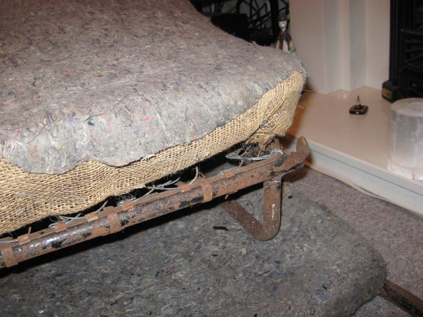

mr magyar wrote:
Hi,
Here are some photos of the seats from my '49 Standard after the original outer fabric had been removed. There's a layer of the brown sacking like material against the springs, then the grey wirey padding (synthetic horsehair?), another layer of the sacking and finally a layer of the soft, thick grey padding which I think in the UK it's known as shoddy.
I have more photos if you need them for reference.
Cheers,
Andy.
