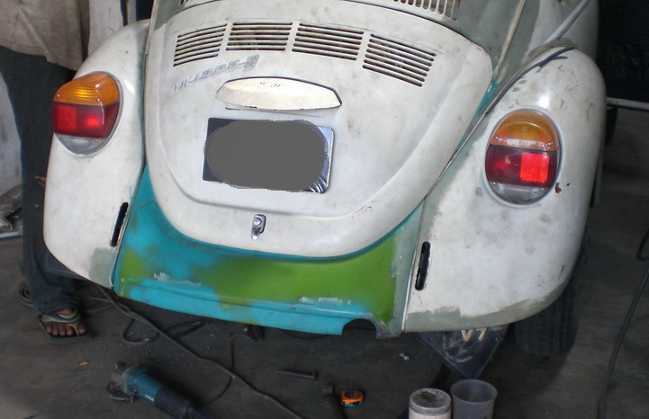

Replacing the rear apron is not on option list; it would have to be an exhaust and heater boxes (J-tubes is possible, but not desired) that fits the existing, righthand cut-out of the bulged apron type. Mexican cars have the single outlet on the left as I can see and maybe also slightly more towards centre.

No need to replace the apron, just add a cutout to the existing apron. There's a flat section along the bottom and that's what everyone uses.
An otherwise original 1979 cabriolet in all black will keep its original feathers where can be Smile
But yes, simple if one wanted or did a very comprehensive modification with less emphasis on originality. This car to my knowledge has no panel replacements although some minor body work and paint along its lifespan. And a very irritating parking fender bump on the lower left one while should be manageble by micro-corretion/non-repaint type dent correction.
