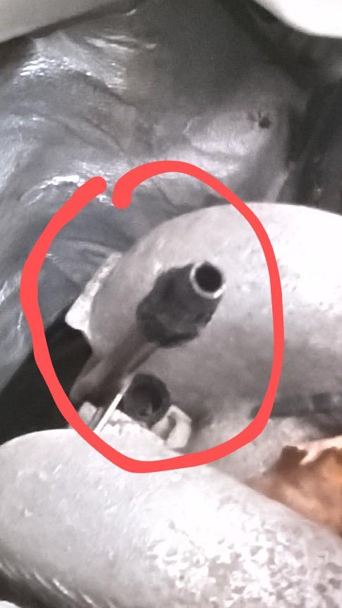

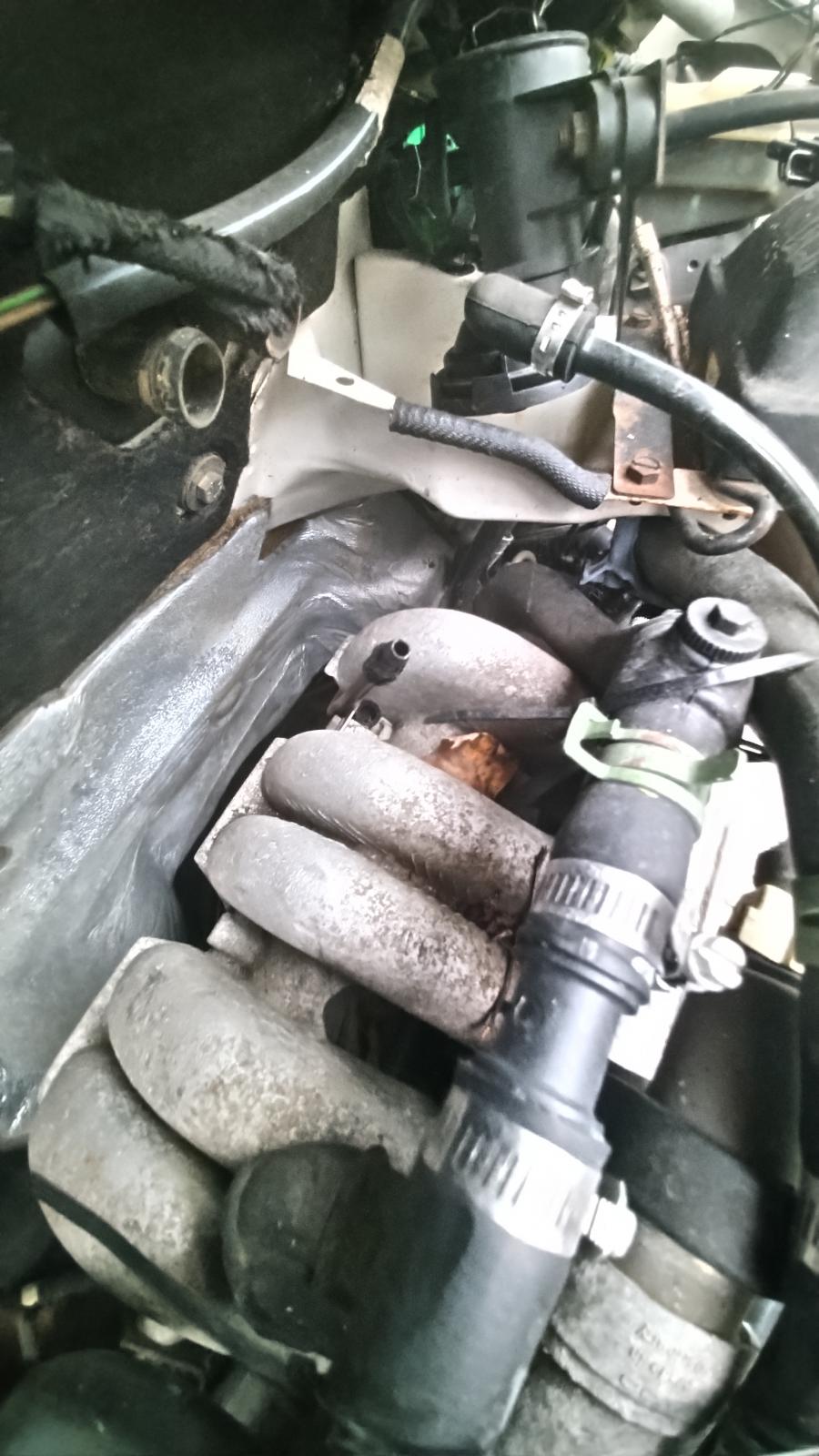

Trying to figure out why my 2.5 5cyl is running rough under load. There is definitely something missing and I'm looking for information about what goes on this tube. It's blowing hot exhaust when running.

I believe that the tap port to sniff the CO before the exhaust goes into the Catalytic converter. It should have a plug on it obviously.

Part number is 034133335d. Here is a link to the part on Busdepot.
https://www.busdepot.com/034133335d
