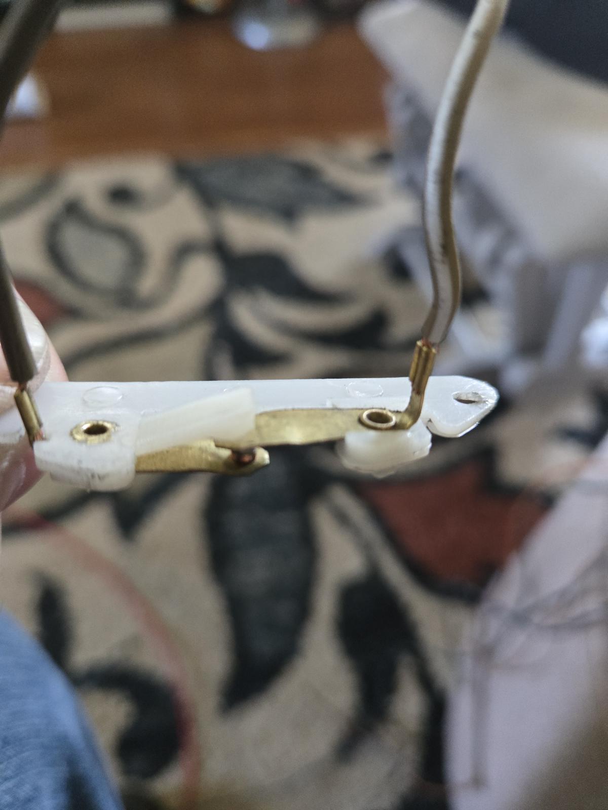

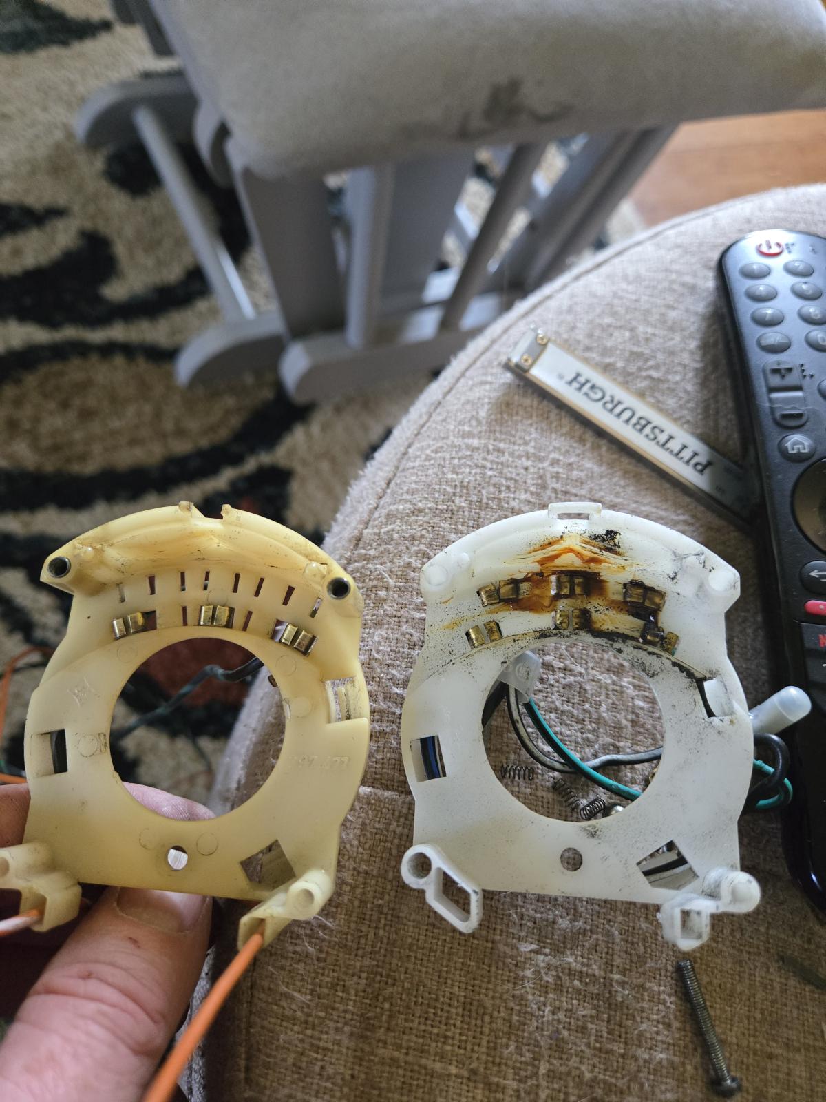

I rebuilt my original SWF turn signal switch. I had a Classic Line aftermarket switch that was broken and I used it for parts. It was really weird how well Classic Line copied the original design but still made a crappy switch.
The plastic parts were all identical to my SWF switch as were the springs. The brass contact parts were slightly thinner but still very close. The big difference was the the switch arm. The SWF arm was way heavier and well cast. The CL switch arm broke and had a lot of rough casting marks. My SWF switch had broken plastic bits for the dimmer so I swapped that part and used the oe parts for the rest.
This was not a lot of fun to put back together and I found that having an extra set of hands is the way to go.
The big thing to know is that you can't get the rivet that holds the switch together. It is ok because a M4 x 16mm Chicago Screw is available on Amazon that works perfectly. I did have to chuck in my drill and "machine" the long end to fit with my bench grinder as well as take a little bit off the female end to get the perfect size but it really wasn't too difficult. I also sourced a longer M3 Allen screw at my local hardware store because the one the Chicago screws came with was too short. Since I already had the busted CL switch, this job only cost me $8 and the switch works like new. I used Super Lube to hold things in place during reassembly and for its dielectric lubricating properties.
Chicago screws aka bindery post:
Sorry if the photos are in a weird order, I'm posting from my phone and I can't see the thumbnails very well. I hope this helps anyone trying to save an original switch.
