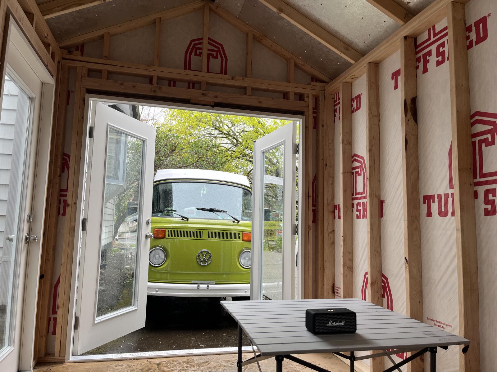

Yes Ray exactly what I plan to use in our new 8X20 shed. Unfortunately our 1925 house didn’t have suitable driveway space for the width of modern car.
