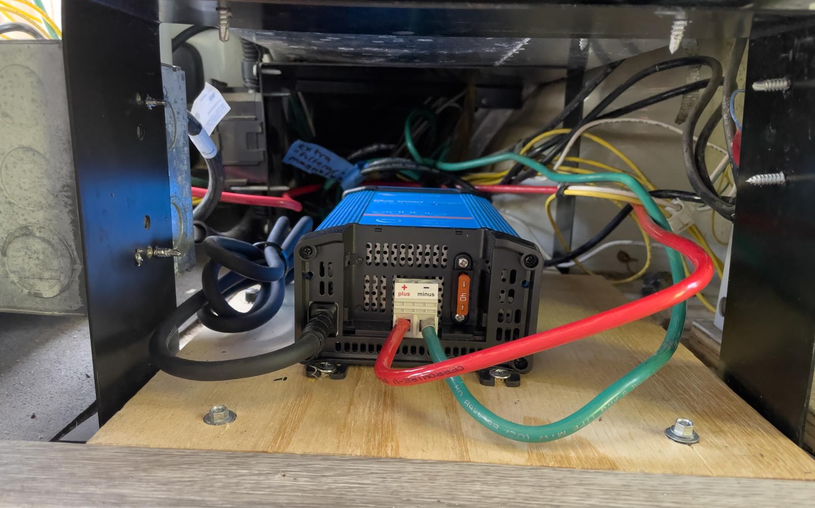

eurojudy
Joined: April 16, 2022
Posts: 23
Location: Petaluma, CA
eurojudy is offline
PostPosted: Thu Jun 12, 2025 4:01 pm    Post subject: Re: PD9300 charger max amps? Reply with quote
UPDATE: I found a mobile RV guy who came over just a few days after we connected. I found out he is a recent Ukrainian refugee and could not have been nicer, smarter, friendlier, more well-equipped or patient, letting me hang out with him and ask questions etc. He hadn't worked on a Eurovan before but using the instructions I printed out from xochi.com and 1705.net, and a liberal use of chatgpt (!), he got it done in 4 hours. I ended up using the Victron IP22 and all is well.
