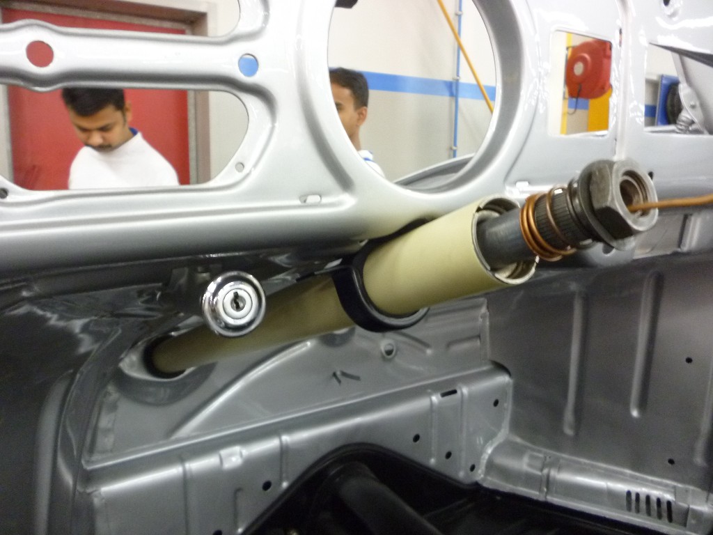

the only difference is the cabrio hood release knob can be locked to prevent people reaching into the car and accessing luggage etc when the top is down. other than that it is basically a knob on a cable which acts on the latch so a saloon set-up should work but might need some changes where the knob lock fitted.

Sedan Hood Release cable can be used without a problem, provided that you weld/glue a piece of metal pipe to extend the existing one, mimicking the sedan.

You literally could use a $15 tractor choke cable and make it work
If you have the handle... its just solid cable..
If you need a handle...here is a cheap one ?
https://www.thesamba.com/vw/classifieds/detail.php?id=2724784
There are a few differences between the Sedan and Convertible hood release handles.
Sedan the cable is crimped into the handle.
The Convertibles the cable is pinned or screw attached to the handle. Karmann just cut the Sedan cable and pinned it to the Convertible handle
Location and locking ability for Convertibles.
The Convertible handle is longer to reach the moved Sedan cable tubing.
As advised by Disc, Youd have to add some tubing to make a Sedan handle more user friendly.
