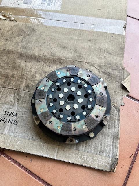

PostPosted: Tue Jun 10, 2025 7:52 am    Post subject: Re: Problem getting reman trans out of gear Reply with quote
Found these pics when it happened to me. So much rust on the flywheel couldn't release the disc. The disc is one of those with different materials on each side from Aircooled.net and the flywheel is Kennedy Stage 1.
YIKES! All of that in my car is new; but that doesn't mean it can't happen. Hopefully it is just the clutch that's the problem. I have another Luk clutch kit on the way just in case.
