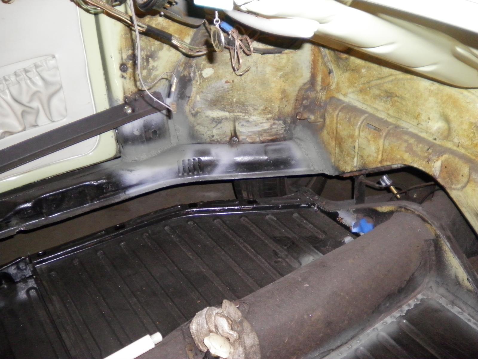

Either way you look at it the body will have to be separate from the frame. Even if only by a few feet. When I did mine on a previous '62 hardtop I braced the door frame in by welding in an old steel bed frame metal, I also removed the doors, then after taking all the bolts that hold the body to frame I made 2 saw horses, raised the frame & body up at one end and dropped the bumper brackets down on the saw horse, then the frame separated and I lowered it to the floor. You might get away with leaving the bumpers on .Then I did the same to the other end. Your new heater channels will have to match up with the bolt holes in the frame so it's easier to have them separate to bolt the heater channel to the frame and lower the body on to. If you don't it may not line up and it will be more work ovaling the frame holes to make it fit. It would seem to me it would be more difficult to work around not separating the two. Also, I welded in other new metal while the two were apart. Both a pillars , d.side crossmember , etc... If your vehicle needs channels it will also need other metal. I'm no expert on the matter, it's how I did mine though.
Photo from my samba gallery...
One other tip , before welding in heater channel install the defroster hose. Even if you think you're not going to use it , you may change your mind later. And it's a bitch to get in the other way.
