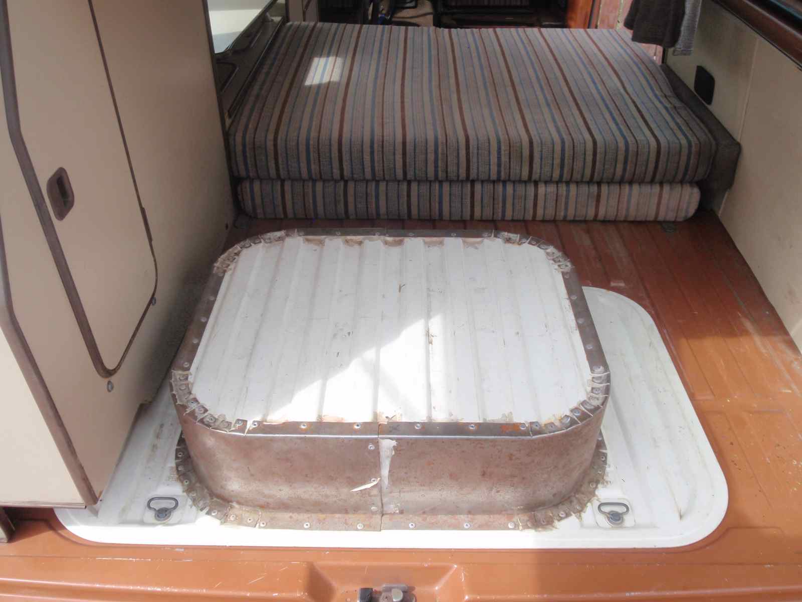

Hello,
Very first post here. I'm considering buying an 87 vanagon converted to, per seller, a 2.0 ABA motor from a 97 Jetta. The motor protrudes above the normal trunk floor and has been outfitted with a circular custom cover, eating some trunk space.
I've done some research on this forum and can't find other examples where the ABA motor protrudes in this fashion. The seller bought it from the person who did the conversion and doesn't know much about cars to answer such questions.
Thoughts? Is this evidence of a micky mouse job? Any idea why conversion would have been done this way?
Thanks!

Pretty common to have a pop up raised 2 inches. If it looks like the below then it's not common.
Post a pic.

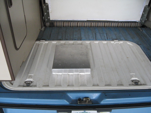

That’s not necessarily a mickey mouse job but possibly an odd choice if it looks anything like the above photo. Some of the best conversions raise the lid a couple of inches and add some handy storage space, e.g. SAH 1.8T:
https://www.h2ovanagon.com/1-8t-installation-pricing
As mentioned, post pics.

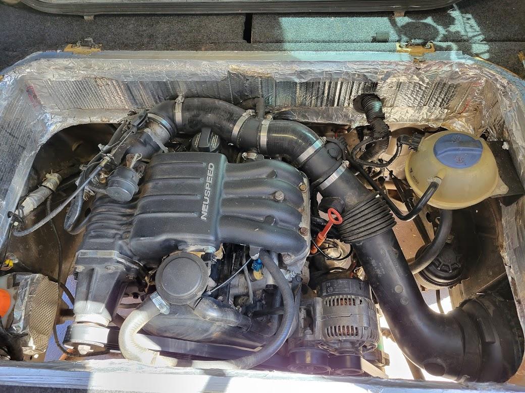

Here's my supercharged ABA with a house built around it. It's not pretty but it's been a fun motor for about 30k miles. Mounted at 15 degrees (instead of 50, as some are) it sticks up 3-4 inches above the original deck.
Joe T.

Pherball wrote:
...... I'm considering buying an 87 vanagon converted to, per seller, a 2.0 ABA motor from a 97 Jetta. The motor protrudes above the normal trunk floor and has been outfitted with a circular custom cover, eating some trunk space.
.....The seller bought it from the person who did the conversion and doesn't know much about cars to answer such questions.
Thoughts? Is this evidence of a micky mouse job? .....
Hi.
Is the Vanagon in question a camper van?
re: posting pics. If possible, please include images showing view of engine from above and below.
In general, installing a "stock" ABA into a Vanagon requires that the engine cover be modified or raised. In a way, that's not a bad thing: mounting a "stock" ABA so it fits below the engine lid can involve more work and trade offs than one might think. btdt.
If the quality of work done on the engine cover looks questionable, that might be an indicator that "micky mouse" work has been done elsewhere on the van or on the engine conversion.
Neil.

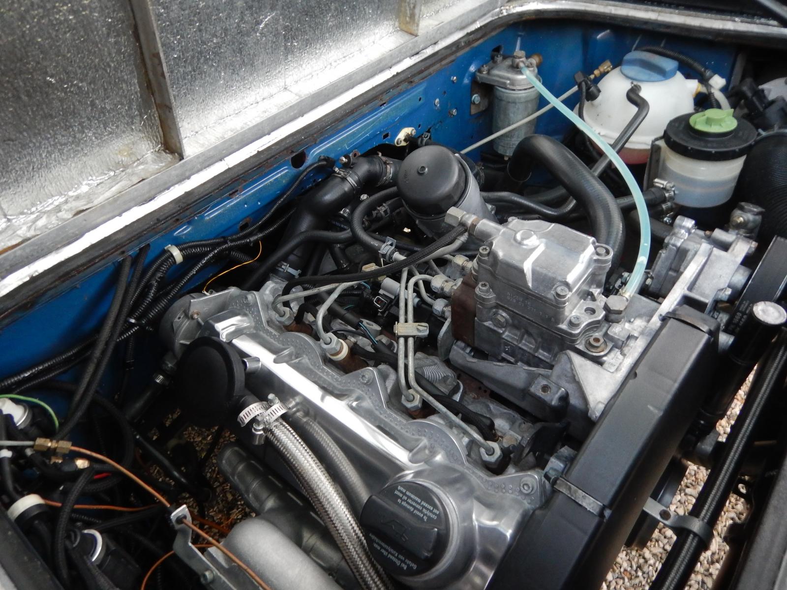

Below is a photo of the raised custom engine cover in my 84 Tin-top with a TDI engine. This photo is not of the finished version. I covered the wood frame on each side of the engine bay with thin paneling and a black leather like vinyl stretched tight. The aluminum lid is custom made. I did add sound deadening insulation on the bottom side of the lid and covered it with what you see.
The OE cover goes over it. It has worked just fine for over 12 years. It is about three inches high, maybe a little more.
'84 Vanagon Tin-top, ALH TDI, two trips to Alaska, 2014 & 16. 1989 Tin-top unmolested.

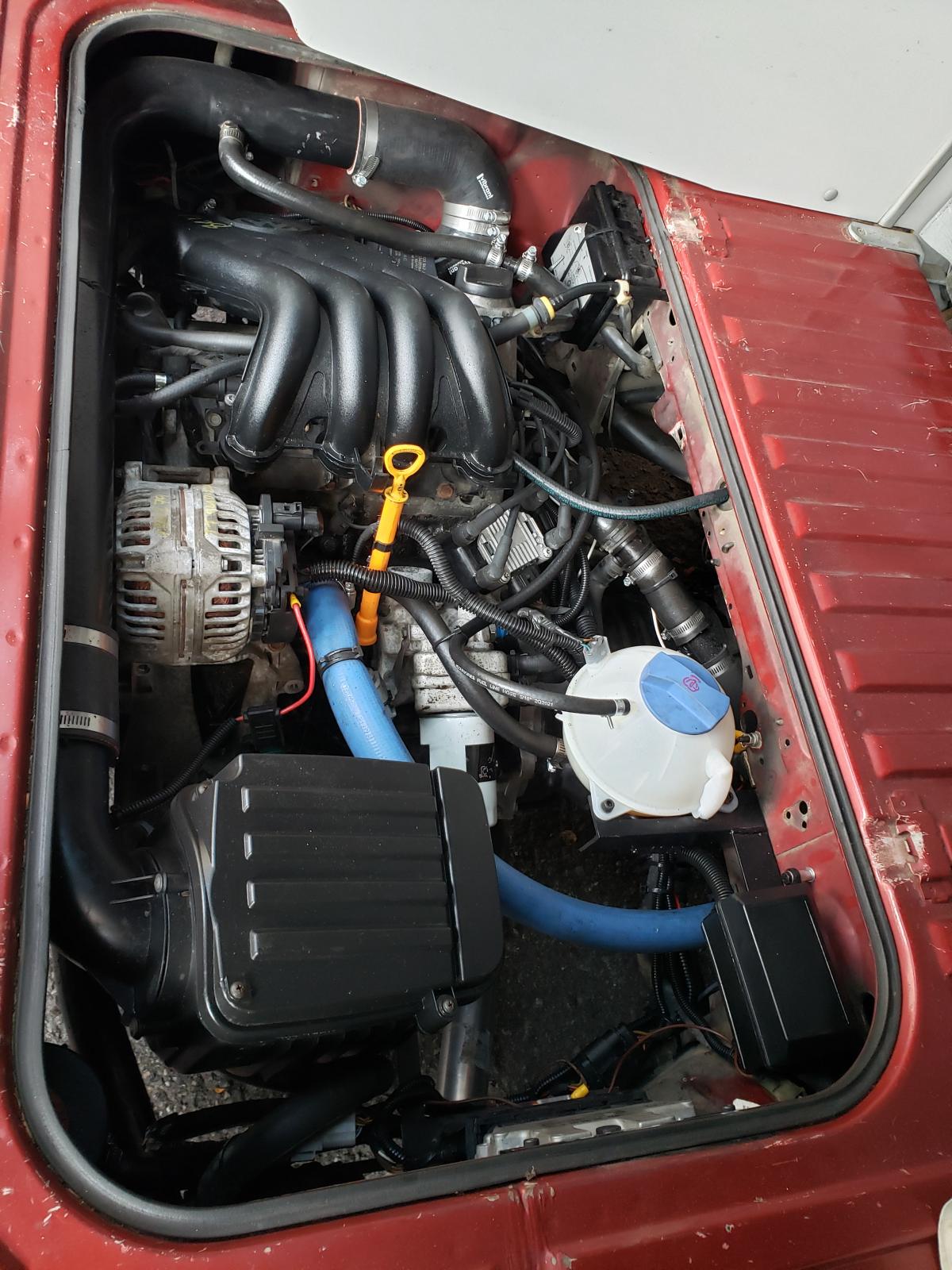

I am pro 50 deg. It looks a lot better, you lose a bit of ground clearance but that is the only disadvantage I can think of. You can solve the ground clerance issue by raising the van which looks better in the end. There may be some surprises in your potential van or... it may be great. Good luck with it. Picture?
87 Titian Red Westfalia 2.0 VW I4 SOHC manual Ottawa, Ontario

The OP's photo showing the engine cover indicates to me that the Jetta 2.0 in there is most likely mounted at 15 degrees.
For point of reference, for my 15 degree mount Jetta 2.0 (ABA engine), I raised the engine cover ~ 4" This is on a Vanagon Westfalia hence my question on whether or not the Vanagon in question is camperized.
