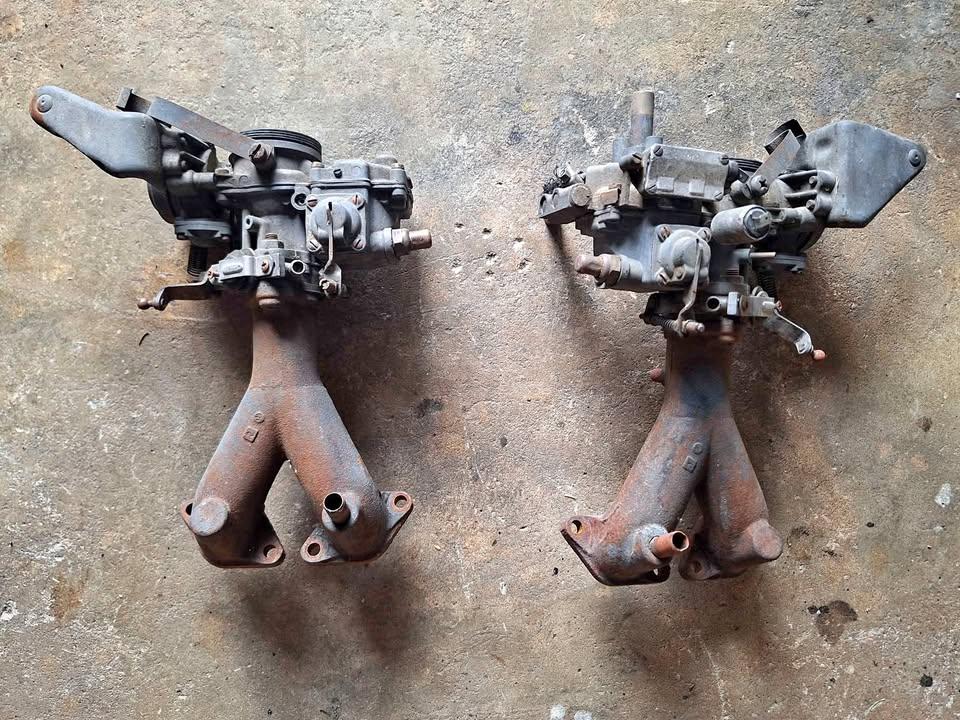

Hi all, can anyone help ID these carbs please? Would they work well on a stock 1600 DP with an exhaust? Going into an offroad buggy, no engine bay restrictions. Thanks.

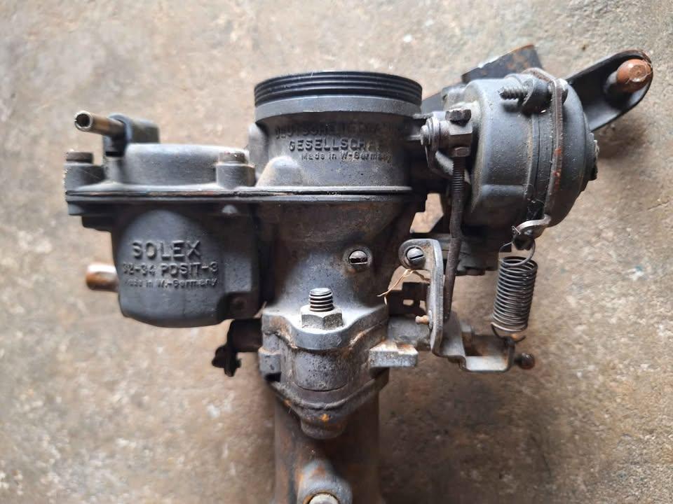

They are pdsit carbs, on type 4 manifolds.
The type 4 engine came in 1700, 1800, and 2000cc
So one may expect these carbs to have larger venturis than used in the 1600 type3 or Brazil 1600 which came with these carbs oe.
They might work well, but its all up to you to make it happen.

I have a set as well that need a real good soaking and clean up. At one time I thought about using them on my 1641 SP. The engine they came off got a set of 40mm Webers.

It will be awkward to plumb the central idling system on a type-1 engine with the fan housing in the way. I think these would probably be about the most difficult twin carbs to fit to a type-1, you'd have to be determined and I don't see it being worth the effort personally.

PostPosted: Mon Jun 09, 2025 6:51 am    Post subject: Re: Dual Carb ID Reply with quote
If you mean "Will they bolt right up to a 1600 and function?" the short answer is
no.
The Type 4 manifolds are different from anything that will bolt up to Type 1 (1600). To make them work on Type 1 you need a pair of '67 Type 3 manifolds from the one year Type 3 that was dual port / dual carbs.
A linkage would be nice, too. The good news is they have the linkage brackets.

Certainly not a bolt on but with a few rudimentary skills it should not be difficult to adapt them especially on a Buggy.

The trickiest part will be the linkage, you will probably have to extend the "plates" on the carb that has the ball on it. Then gather up varies linkage pieces. Very doable if you have the tools.
Remember, even brand new carb kits are not just bolt on, unless you are extremely lucky.

Agreed, also they are hard enough to setup properly for a stock bus engine for the uninitated, I can't imagine trying to make them work on a different engine

Its been quite awhile since I messed with this style carburetor. Are these the carbs that use one carb for the idle circuit, then plumbs it to the other carb?
If so, I would skip on these carbs. I used them when I 1st put my Type 4 engine in my Squareback, and tuning was a nightmare.

I THINK they have a larger base than a type III carb and wont bolt on to one of those manifolds either....have to dig through some crap in the shop to check...the sheet metal screws crammid into the stipped holes holding the electric chokes on arent a great sign...I'd pass and leave them for someone trying to convert their injected bus back to carbs
