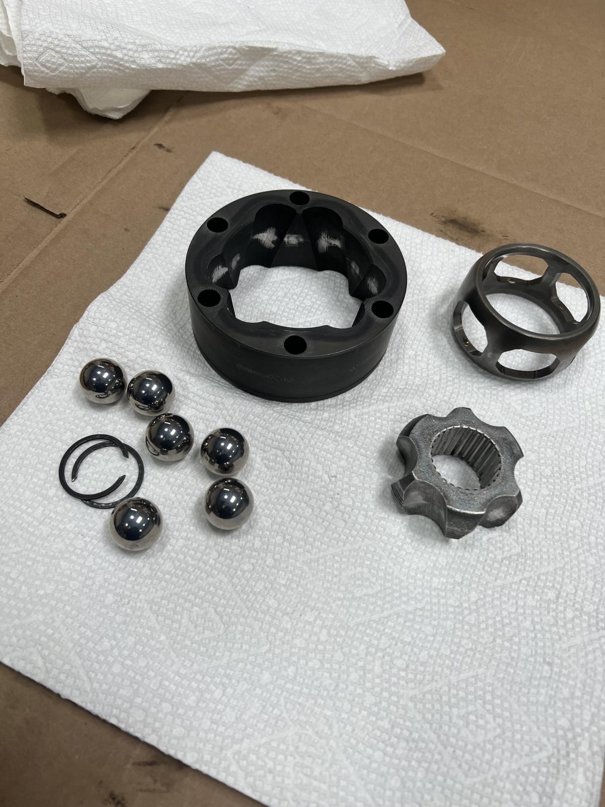

I have switched to Swepco 101 for my CVs and am very pleased with its performance. I put an average of 10,000 miles a year on the van. I had previously been using the Redline CV-2 that GoWesty sold. I was in the habit of servicing the axles once a year with the redline because it seemed to not hold up. It just did not seem to age well. After the rainy season (November to march here in NorCal) the CV-2 grease would be milky, runny, and just seemed to have broken down. (sorry no photos) I assumed it was absorbing water due to its appearance, but it could have just been the grease falling apart.
Four years ago I replaced the CVs and switched to the Swepco grease. Since then, I have serviced the axles twice (now once every two years about 20,000 miles) and this grease is solid, it does not get runny, and I honestly think I could let it go quite a bit longer than I have been.
Cleaning these up the grease still seemed like new, I would be comfortable running this grease longer at this point. I also feel that if you were one of those "types" who would prefer not to do this messy maintenance task, that this would be an excellent candidate to be the "lifetime" grease you put in there and forget about it until the joint started making noise.
First two images are of a CV as removed from the van, 2 years and 20000 miles on the grease, 40,000 miles on the joint.
These are images of the joints after cleaning them up, they are just starting to break in and get shiny wear spots.
One tube was enough to do 3 joints, or two if you wanted to pack the crap out of it and put a lot in the boot, now quite enough in my opinion to do 4 joints though. YMMV

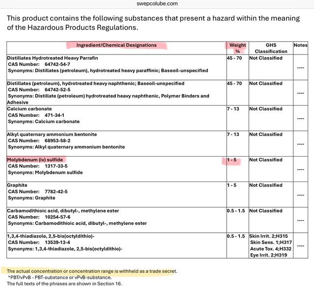

Just curious, do we know what % moly in the Swepco? Couldn’t find it on the link…

https://swepcolube.com/products/swepco-101-moly-grease/
Safety Data Sheet (SDS)

^^^ Indeed. Saw that, checked that.
FWIW, the SDS only gives a “range” which reportedly includes the amount, but does not specify the actual amount. WTH???
Without an actual number, there is no evidence that Swepco is any better than any other grease with 5% moly. (Or possibly even less…???)
Still looking for an actual answer…

while Amsoil is good at disclosing the percent moly in their formulations, Swepco is not. the Swepco MSDS says 1-5%. whatever.
while moly is great, i'm not sure the percentage is of great consequence to us in CV use. things like flowability, water resistance, oil separation, and wear tests that make a good CV grease are probably better indicators. as is real world usage reports from valid sources.
