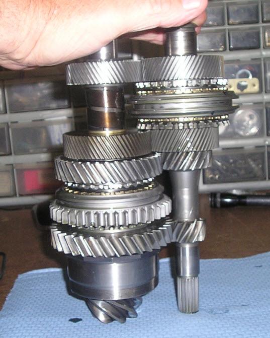

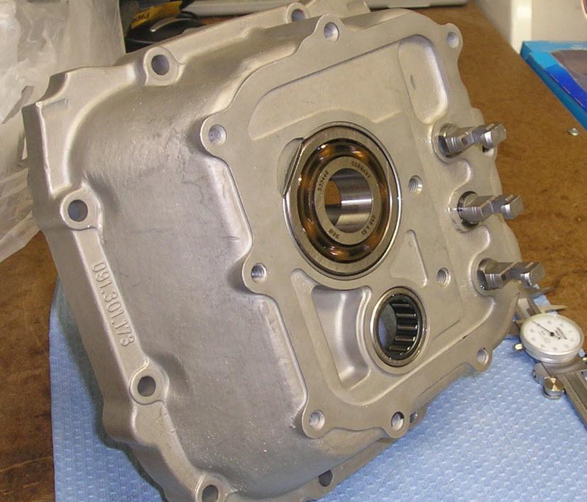

the indents in the selector hold the shift rail in position. If you can fully engage first gear and it pops out, it is a more serious problem. The shift linkage is designed to shift the different shift rails, not hold it in gear. If you can put it in first gear and not hit the E-brake or ashtray, the problem is in the transmission. That is my opinion. Once the main bearing wears into the nose cone, the gear does not fully engage and that can wear it funny and cause it to pop out. Sometimes it can be saved with the plate from Weddle.
You can see the three shift rails on the right. The shift linkage moves those and they in turn move the gears, and lock in place with ball bearings and pins that lock into indents. The three are made so only one can be engaged at any time, and when all three are lined up it is in neutral. So if you can push it all the way into first gear, the shift rail should be locking the gear in place. As the big center bearing wears into the nosecone, the whole mainshaft and gears change tolerances, and bad things happen. Weddle makes a steel plate that pushed the main gear back into place. It is a work around kind of fix but it may help. To use it the nosecone has to be milled the thickness of the plate.
These are 091 photos but 002 is almost the same.
first gear
first gear

well the issue is that if you push it forward into first gear, and the gear knob stops moving before hitting something, then in my opinion it is going into first gear, and the selector and gears should hold it locked there. Sloppy shifts, having trouble finding a gear would be a stop plate or linkage issue. But you are finding first gear - it just isn't staying in it. You are in the UK, is this correct? Maybe MikedJames may know someone who can assist you. He is in Hampshire.

If that is the case, I think you need to
1. Check the motor and transmission mounts to be sure they are intact and not broken. Check the grub screws for tightness, and the shift coupler for wear. If you find issues, fix them then see if that helps.
2. Prepare yourself to either add the steel plate yourself and hope that does it, or send your transmission to be rebuilt. You can also replace the ball (doughnut) in the nose cone when you are in there and check the selector.
The selector rails pull the shift fork, which engages the gears. Only one shift rail can be used at a time - so when the 1 - 2 rail is moved one way the shift fork moves the slider hub to lock the transmission in 1st, and when it is moved the other way it locks it in 2nd. Before 3 - 4 or R can be selected, the 1 - 2 rail has to return to the neutral position. I mean sure, look over the grub screws for tightness, check the coupler at the back, check the mounts, but be prepared to have the transmission repaired before 1st gear is damaged.
It takes more cost in specialty tools, and a lot of knowledge to rebuild a bus transmission than to pay to have one done.
Below is a video of the shift rails being moved with the gear carrier mounted in a jig. The issue you may be having is that the whole gear cluster has shifted if the main bearing has eaten into the nose cone, which they all do. The steel plate pushes the bearing back where it should be, but it will be back in time. Hard to say what the issue is for sure but that would be my guess. Once the gear wears funny it will keep popping out no matter what, so you want to stop it as early as possible.

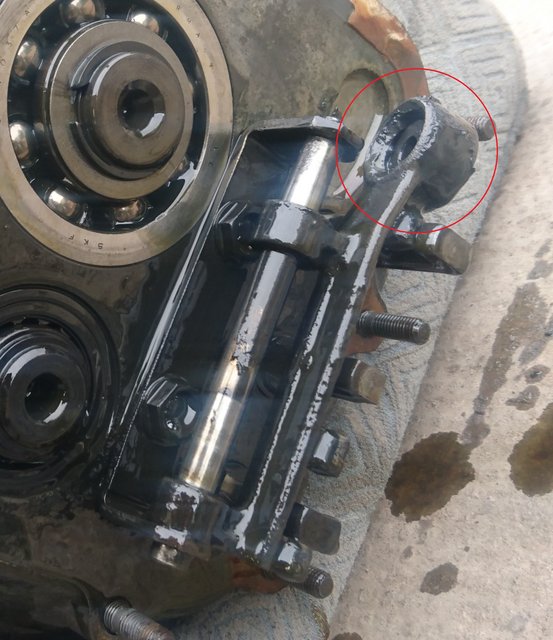

That said, to the OP, unless you knew what to look for, it would not have been obvious. Read these quotes below from a recent thread. There are many more like it but this is a recent one. In his photo like this, you can see where the main bearing has eaten its way forward. It should be flush. By all means check the coupler and grub screws etc., but I think in the end you will find this as a possible problem. It may have already worn out the slider hub and the gear so it no longer locks the gear in place. Here is a good explanation. Rick Long retired so his website is no longer available but there is a copy of a technical page on archive.org. Be patient for it to load. https://web.archive.org/web/20180128224141/http://www.longenterprises.com/remachined_sliders.htm
poundman wrote:
While I am waiting for the correct needle bearing I have shifted to the transmission (pun intended). I replaced the final drive seals and caps. Then I replaced the seal behind the throw out bearing. My first question, is this the correct position of this tube. I didn't pay attention to how it was removed. It has some opposing holes, I am not sure if they should go up/down or left/right or does it even matter?
Next, I switched to the nose. If you look at the original pictures of the transmission, it appears it was leaking from the nose area. Not sure if the seal or the gasket of the nose cone. It had a lot of build up.
I plan to replace the seal so I needed to remove the nosecone. Here are the pictures. Do you seen anything out of the ordinary? I read on ratwell about the ball joint that wears out. You can see mine is worn out, and the plastic shavings in silver at bottom of cone.
Would you replace with a steal ball joint or try the original plastic type?
https://weddleindustries.com/products/004-301-241-A-HD/004-301-241-A-HD
https://www.heritagepartscentre.com/us/004301241a-transmission-hockey-stick-pivot-ball.html
When I reassemble, should I put some grease on these moving parts?
