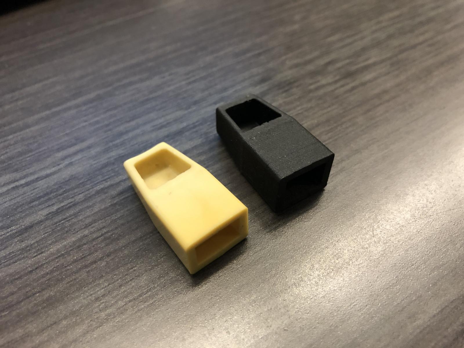

1967 Bug Engine Latch Cover
Did not know that this part existed. No sure what is the purpose of this cover. Saw it being discussed on Samba so I made it.
The original is flexible, sort of like PLU. I made this out of PETG. Should be able to withstand engine compartment temperature.
It is not flexible, so I had to extend the slit for the latch to go through.
https://www.thingiverse.com/thing:5495567
