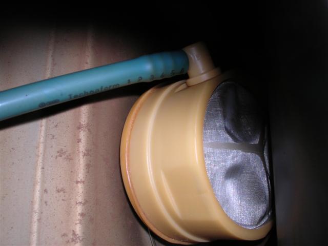

I seem to recall some cases of the in-tank pickup coming loose and thus unable to access the last few gallons.
That may seem counterintuitive since the outlet is right there at the bottom corner of the tank but I think it's a bit more complicated than that.
Yes pick up tube or filter may come loose...

An interesting theory for sure and one that’s a pain in the rear. I’ll keep an eye on that and drop the tank if I must.

It's not uncommon for the tube going from filter to tank outlet to develop a leak. When that happens, the tank will only flow down to the point of the leak (e.g. at 1/2 or 1/3 of a tank). The rest of the fuel just remains in the tank. That happened to me in my '91. It would only accept 7 or 8 gallons and would "run out of fuel" when the tank was still ~1/2 full. Replacing the tank is the simple solution.
This is a very good point. ^^^
And, not to take away from the OPs Thread here, but I believe that's what has happened to my aftermarket tank. When I get down to about 3 or 4 gallons, going through curves hard, it will suck air and shut down the TDI engine. I've had that to happen several times.

couldnt you fix just fix the tube instead of replacing the tank ? im not faniliar at all with Vanagons .
Replacing one of the pipes/tubes inside a fuel tank would be almost like changing the carburetor on a V-8 though the exhaust pipe.
Take a look at this thread... https://www.thesamba.com/vw/forum/viewtopic.php?t=630469
<see below>
?Waldo? wrote:
It's not uncommon for the tube going from filter to tank outlet to develop a leak...
I took this to mean the tube inside the tank, from the screened sump pickup (pictured above) to the outlet. No way in there without going in there.
Semantics… <shrug>

OK silly me !!! like i said i am not familiar with these and i see what you mean now !!! thanks steve
un serviceable !!!
