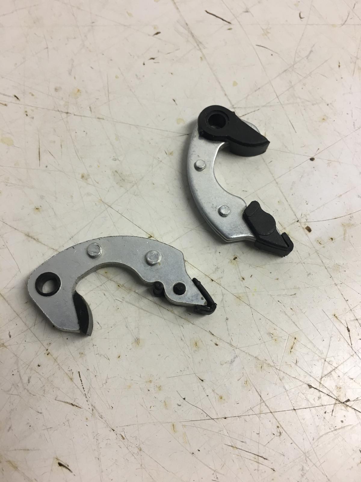

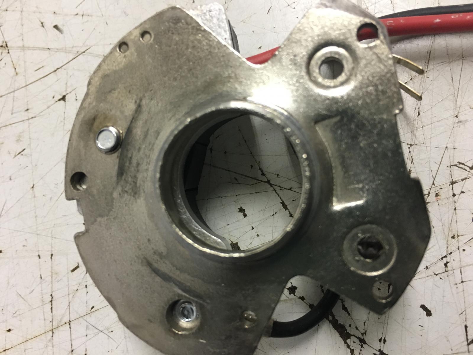

What's with all the plastic parts? I have been wrong before but can plastic really hold up to the long term use and heat expected here? Every point of contact and bearing here is plastic! Is this ok? what do you think?
This is where I found the biggest problem to be. Vacuum advance plate notchy feeling and stiff. Two ragged stamped steel plates rubbing together with no bearing surface provided. Very crude! Notice the screw that holds the sensor on the left side sticking out? That sucker is dragging on the bottom plate! Filed off the screw and all high points and lubed it up liberally but still not as free as it should be. Note the rub points at 1, 4, 7 and 10 o'clock!
Added some weight to these to see if I can get the advance to come on sooner. Weights were 9.5 grams each, now they are 10.5 grams. Just a stab in the dark.

joey1320
Joined: September 12, 2006
Posts: 2338
Location: Cleveland, OH
joey1320 is offline
PostPosted: Sun Dec 23, 2018 6:34 am    Post subject: Re: Pertronics III observations Reply with quote
China crap do what China crap do...

Thanks for the links Joey! I have not decided on a plan of action at this point. There are a number of options vying for prominence. At this point I just want to get it running well again for February ice racing then have a permanent solution lined up for spring.
This vacuum plate set up is very problematic, to keep it working is going to be an almost daily lube thing!

Those plastics parts hold up for decades.
If you look through my restored distributors you will see in the pictures that in the early 70's Bosch started using that type of plastic.Even before then they had what is called phenolic resin. I put new plastic in many of my restored distributors so they start out fresh when my customers get them. 40 year old plastic can be brittle and it is just a matter of time until it breaks.

There's nothing like a properly rebuilt GERMAN Bosch distributor using genuine Bosch parts.
I say Pertrohnix are no where as good because i've tested a few and taken them apart. The stampings, assemble general build is when you expect from mass produced stuff from China.
Don;'t be surprised since you paid so little.

What did you use to add material to the fly weights? It sort of looks like solder, I want to use this trick myself.
Thanks,
Jeremy
Yes it is solder.

oprn wrote:
Thanks,
Jeremy
Yes it is solder.
I give better than 60/40 the solder falls off within the first 1000 miles. Whenever i'd seen weight added to distributor weights it was brazed and not soldered.
Glenn
