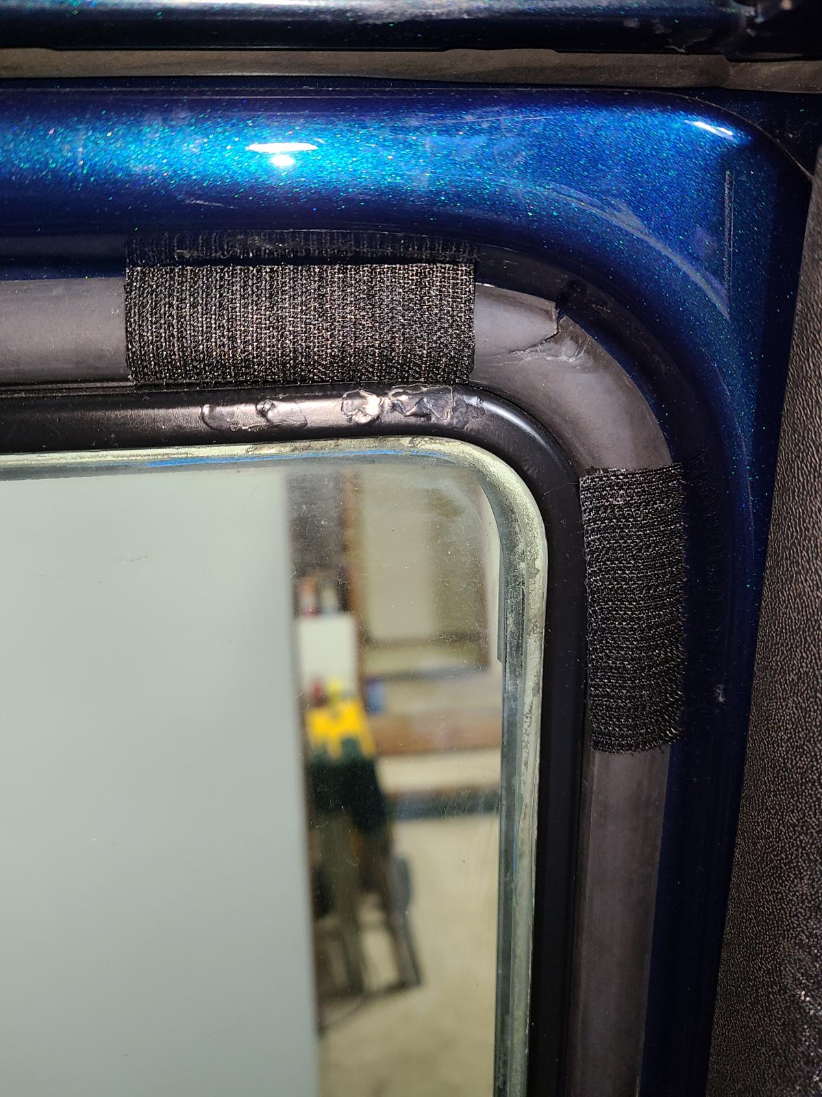

I sewed two curtain panels that snap together and attach to the rubber window seal with velcro on the top and sides, and with little magnets sewn into the bottom hem. I like having two panels so that I can cover just half of the sliding door window if I so choose. I like attaching them to the sliding door itself so that I don't have to duck under them in when entering and exiting the slider. They fold up nice and small, and tuck away in the cabinet easily when not in use.

Ho w the heck di you get Velcro to stick to the rubber seal???
I have tried, 3m brand and it just would not stay.
I ended up folding a a thin piece of metal that inserted behind the seal and folded over to attach the Velcro to.
