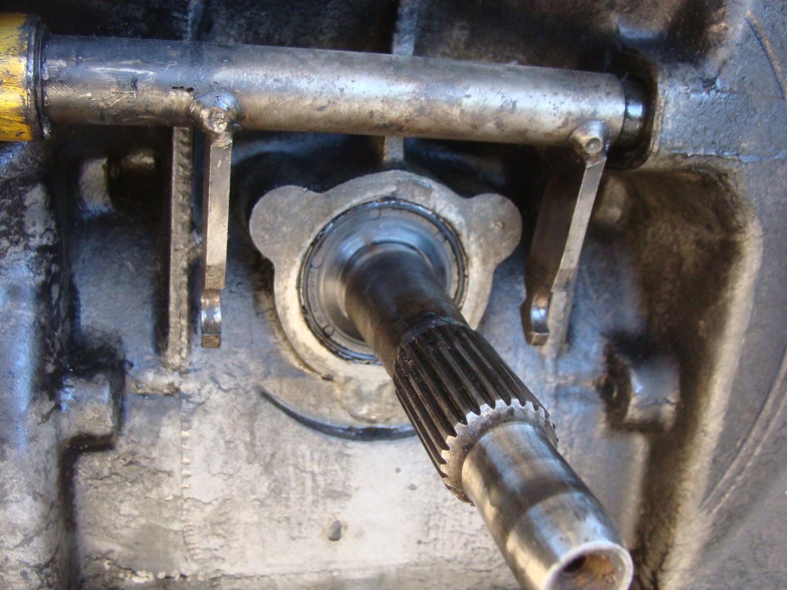

Does your transaxle have the bungs to drill the 3 holes that hold the centering sleeve?

Glenn, it does not. But I don't think I'd need them if I use this conversion kit from Kustom1, or am I wrong?

That kit looks like it would work; it doesn't appear to need 3 holes to be drilled and tapped, like my own 1970 would if I chose to upgrade with STOCK 1971 parts.
1970 transmission has "ears" which could be drilled and tapped:

Aaaaah, THOSE ears. I was looking online to see what Glenn was talking about and didn't see anything. I definitely don't have those on mine.
