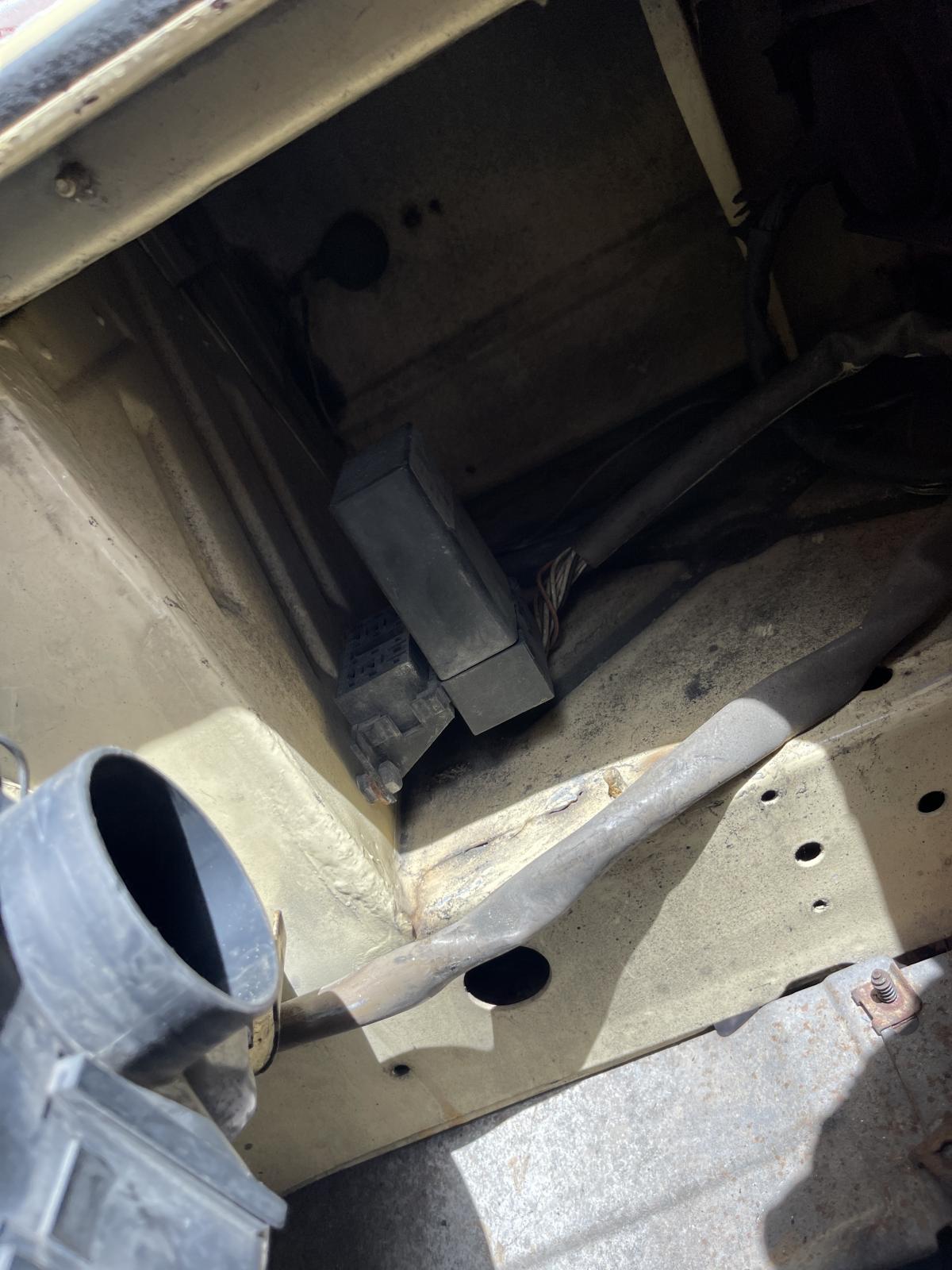

the use of the Digifant I is coming up in another thread and your photo shows a Digifant I in use... can you show us a picture of your engine bay and specifically of the Ignition Control Module, assuming you have one? this could really open up some alternative ECU possibilities!

PostPosted: Mon Jul 21, 2025 7:16 am    Post subject: Re: 1984 Vanagon No spark (fuel ok) FIXED!!!! Reply with quote
My understanding is that the digifant includes an ignition control module inside of it. I did find an idle control module in front of the right taillight. I'll get some engine bay pictures later today.
