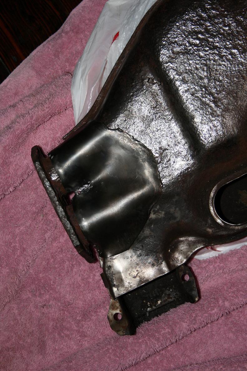

Hey folks! I just wanted to show you how I'm salvaging my heat exchangers instead of buying new ones. I feel the genuine vw article is of much higher quality than those $300 dansk jobs.
So here's how it looks:
Pretty bad I know. So, I took a flat piece of sheet metal and shaped it into this:
And that fits onto that ugly hole like so:
I'm going to braze that piece on for a nice, strong finish. I've got two other places to do this on this exchanger, and then another one to do. I'll be sure to post the next stages so you can see what's going on.

Nice work! So, tell us how you fabbed that patch piece so we can go to school on your experience. Good stuff.
"I will gladly pay you Tuesday for a hamburger today."
tootype2crazy
Joined: October 08, 2007
Posts: 1276
Location: St. Louis Missouri
tootype2crazy is offline
PostPosted: Sat Jul 30, 2011 4:47 pm    Post subject: Reply with quote
Well I took a piece of cardboard and laid it over the offending hole, pushing it into the shape that I wanted it. I then trimmed that up the size it should be. I took that shape and traced it onto some sheet metal and cut it out with a cutting torch. I then laid that sheet metal over the hole and hammered on it in the middle with a chisel and a punch until it went down in between the pipes. Once that middle section was shaped I hammered the rest with a ball peen hammer until it was shaped. To get the detail on where it will be near the seams I used an old screwdriver to put a little notch in. Lastly I used vice grips to make it hold nice and close the the pipes. It took about 1 hour.

we rebuilt our heater boxes too. They look really good when cleaned up and painted. You will be happy with your work when you are done.

I do the same for type one heater box's I even take the tin all off repair the tin and end where the muffler mounts to and put the covers back on. man it would be nice to have some new proper steel covers to put on.

So I got the piece I made brazed on here it is:
Next I moved on to the hole on the bottom which was not as big, have a look:
Now this piece was a real bear to make. the way it angles in relation to the direction of the pipes made it very tricky.
But with a little elbow grease it fits like a glove.

And tootype2crazy, someone did the same braze job on my boxes years ago and they seem to be holding up rather nice. Good job on yours!
