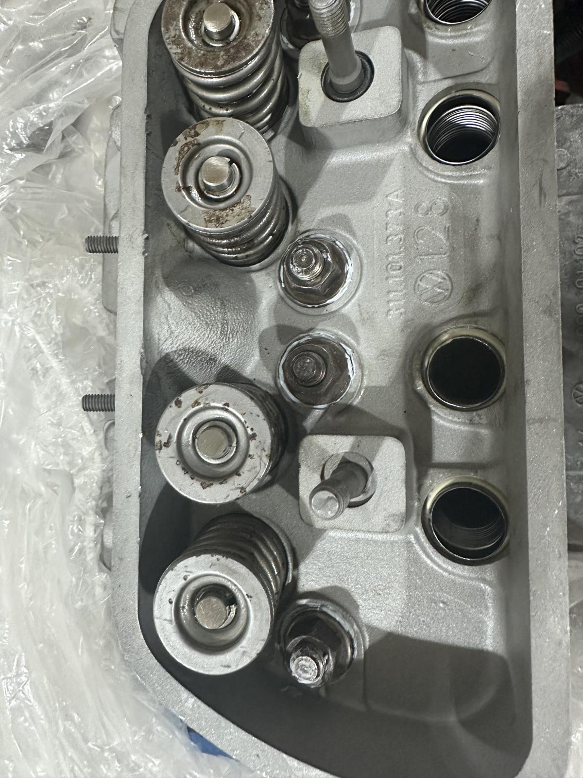

One of the push rod seals is off center a little. Is this a problem? The head is torqued down. They are Eling seals, and I also used GASGACINCH gasket sealer on them.

I’m I over thinking this?

I use a 13mm deep socket on an extension to "massage" the pushrod so the seal fits better.
There's no need for a sealant and using one might prevent the seal from moving to a better spot.
Good idea.
I've never used sealant of any kind on the pushrod tube seals.
I stopped using sealer...whatever you do DON'T use RTV Crying or Very sad
